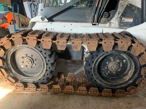

I took the tracks off the bobcat after breaking the studs on front wheel

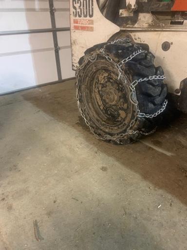

Put these on instead
Will find out in the morning pushing all this white chit

those are the 4 link ones i have a couple sets of the 2 link setups for the little tractor and the bolens
not taking deck off the bolens to put on blower or plow though

Mark I know you are a well seasoned owner operator. But I thought with that track system or the other chain style track system you had to run pneumatic tires. I see you are running Setco solids with that system. Flexibility is limited for sure. And on hard pan or pavement that would be hard on studs, axles, and undercarriage.

These were designed for no flats they said
Yes I’m thinking the same way
Too hard on drive train

The problem was this running them in the snow
Building up on each pad and got too tight
I’m just glad it snapped the wheel studs and not a axle [emoji106]
