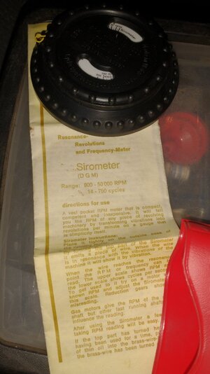

I have used a Briggs and Stratton vibri tach many times and they seem to work well. Cheap and supposedly works on anything that rotates.
