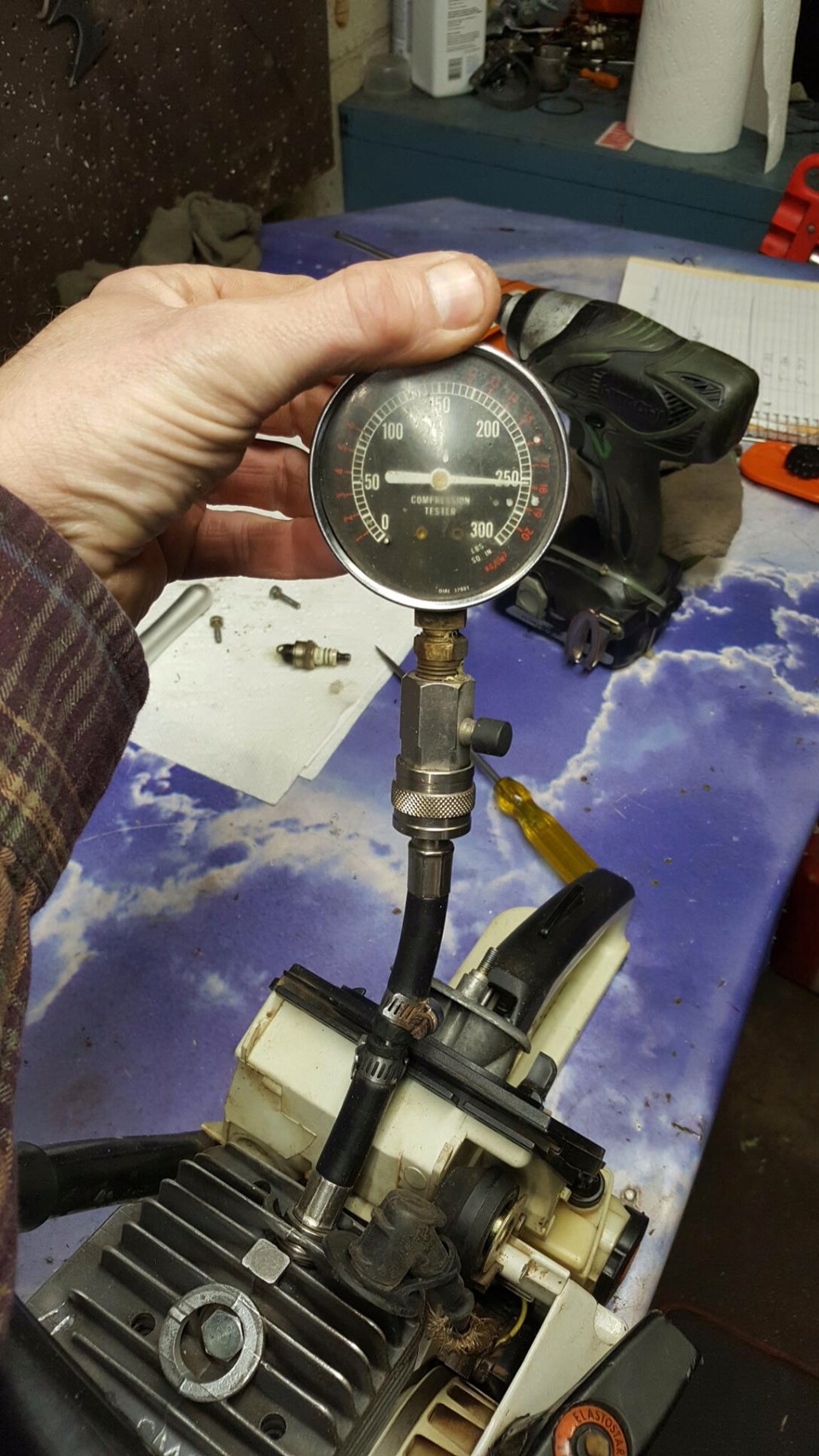

You think the recoil will crank 250 psi with a working decomp? Or just go on fuel and low comp high volume motor. Either way
My 460 had 250 before it was brought down to 200. Lol
