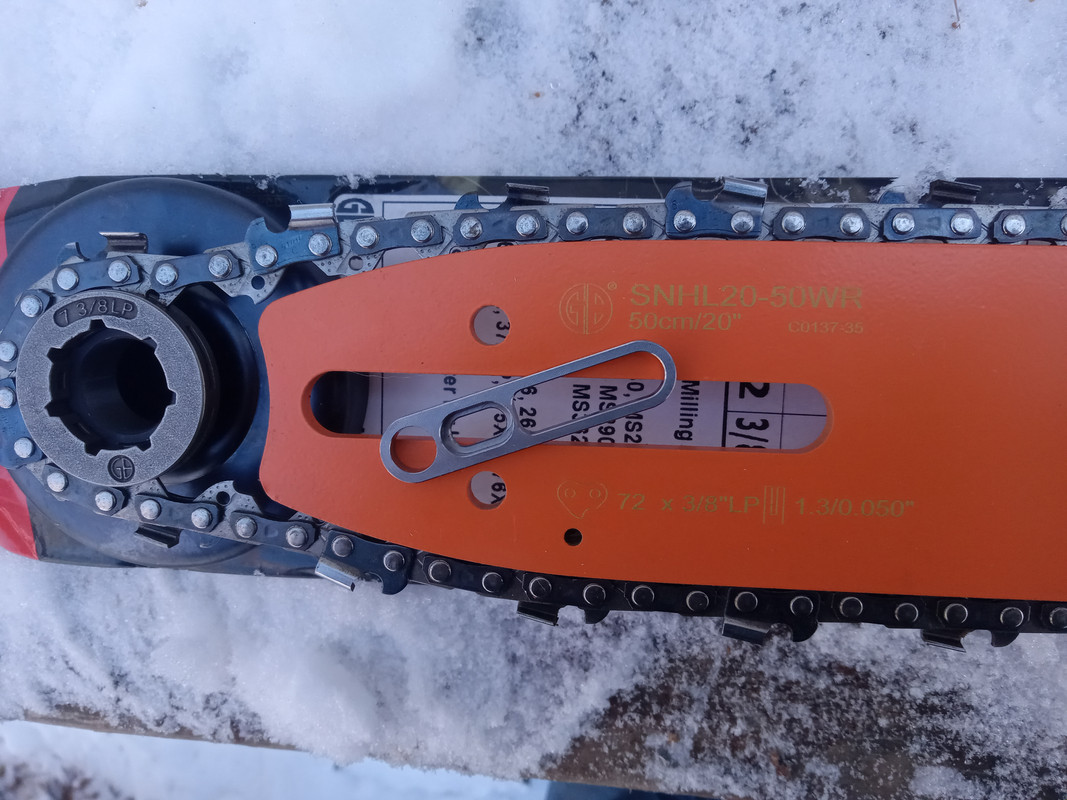

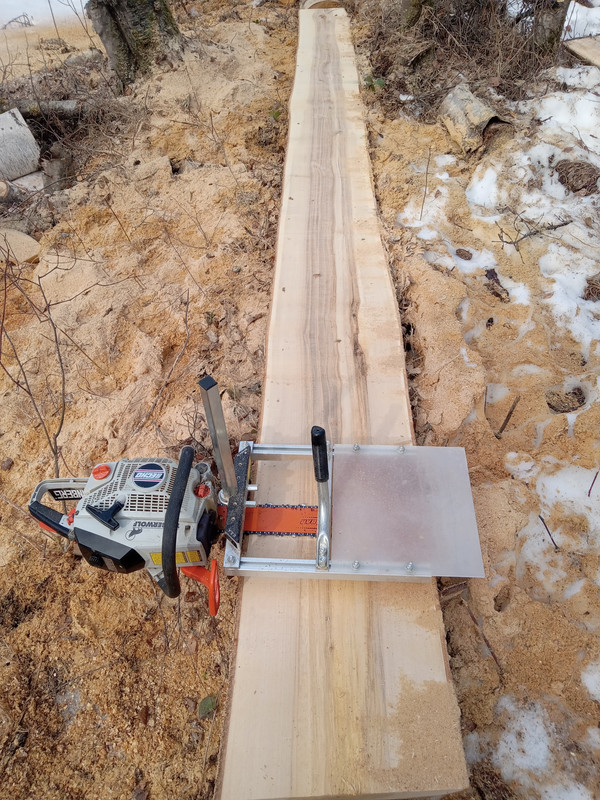

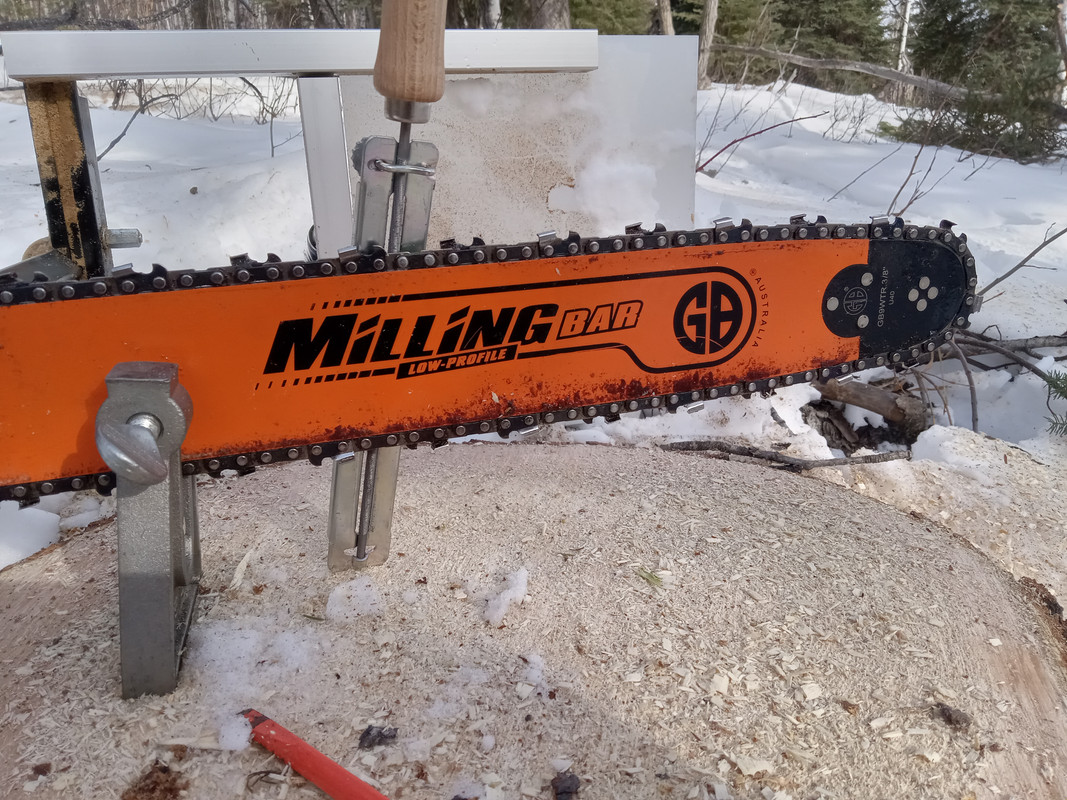

So, I have plenty of small hardwood at my place like 10-14" diameter. I think it would make nice planks for shelving and the like. Would it be feasible to mill with my 50cc Echo and a Granberg 777 or similar small mill? Obviously I'm not talking about huge quantities or getting it done quickly.
Ferg, try to find a used 60-70 cc saw. A 50 cc won't work well at all. I run a g777 frequently, if saw logs are 17" diameter or less. Even then, my 67 cc saw appreciates the 3/8 low profile chain. GB offeres the 20" milling bar and the 3/8 lp rim sprockets that are perfect for the g777 mini mill. Whites forestry sells the gb 3/8 lp milling goodies and ships to the states.
For clarification, your photos show the small-mill (g777) not the mini-mill (g555)

Yep, with 3/8 lp, the 590 would be sufficient. Youd have to pick up a rim sprocket to replace the spur sprocket though. The echo one is very expensive. Archer has a well priced replacement. Traverse creek has them for $16
