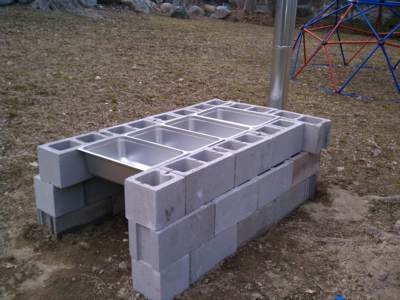

Hotel pans are a great start. Blocks in a horseshoe shape, with 2-4 (or more) hotel pans in a row is how many people get started (including me). Fill all the pans with 1-2" of sap, then light a fire. As the front pan gets lower, ladle from the next pan to top it up, etc. etc. to the back pan. Add fresh sap only to the back pan. As your boil continues, the front pan will get closer to syrup, until the bubbles start to stack up. Check your temperature, you want 7 degrees over the boiling point of water (which you should check each time you're making syrup, as it changes).
Google block syrup arch for ideas, but here's one idea:
The blocks will last longer if you line with fire bricks and/or refractory cement, but it's not an absolute necessity. Likewise, fitting some kind of door on the front will increase efficiency, but add cost.

Thanks. That's pretty much what I was thinking.

The shallower your sap, the faster your evaporation rate. However, you're more at risk of burning. If you can walk the fine line, you can really get a lot of sap boiled off and make light syrup, but you have to watch it like a hawk.
