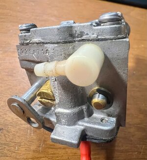

I am in search of a couple of these elbows to replace ones that are cracked and suck air
I am not opposed to trying to rplace them with brass elbows if that is an option. Poor design is an understatement.

AFAIK all those little plastic fittings are the same, both Walbro and Tillotson. We actually stock them under a Tecumseh number (Tecumseh used Tillotson carbs on their little 2-stroke cultivator engines). The Tecumseh number is 640363, not sure about the Tillotson number. https://www.ebay.com/itm/232983935613

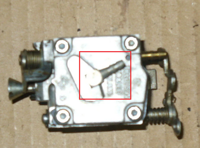

Are those elbows universal for Tillitson carbs? I have a HS-230D that is missing the the fitting from the lid on the metering side:

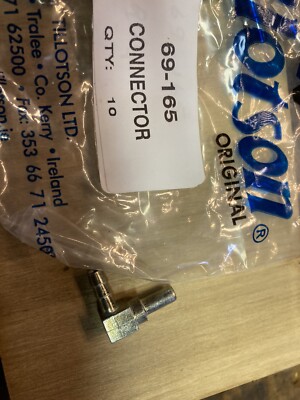

Here is a link to the metal ones.
