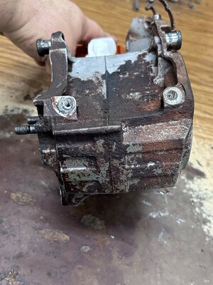

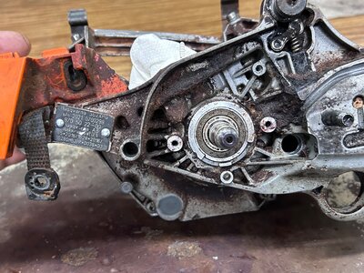

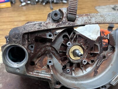

Current theory is clutch side bearing failure cascading to blow a seal and…won’t know what else till I get it all apart.
Compared pics from Kevin from the original build with what’s there now. Uh, a bunch of bearing *s-word isn’t kind to the inside of a nice cylinder. What’s there now ain’t what left Kevin’s shop 🤪. I think Nate got his money’s worth after 4yrs of hard, commercial use. Id also blame Husqvarna for a poor design but they probably didn’t factor this saw wearing a 32” bar for 4 yrs.

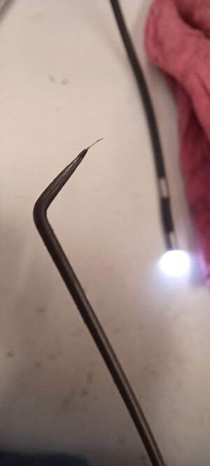

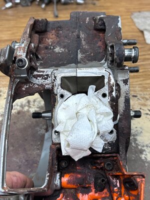

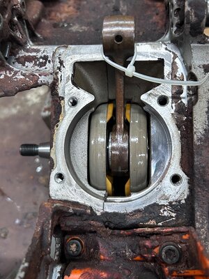

My initial guess as to bearing failure was wrong. With all the reports of crappy, even OE, bearings out there, I assumed...oops. bearings seem fine, crank spins freely with no indication of any bearing issues at all. I have not split the case since I don't have the needed tool for that. With the case stuffers I can't use my usual splitter.
What appeared as metal debris in the bottom of the case with a scope was just a reflection created by the scope cam's light. once I got the jug off to look...zip, nada. nothing metallic at all, case was clean.

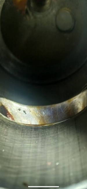

There is clear detonation pitting on the ex side top of the piston so, a bad gas issue?

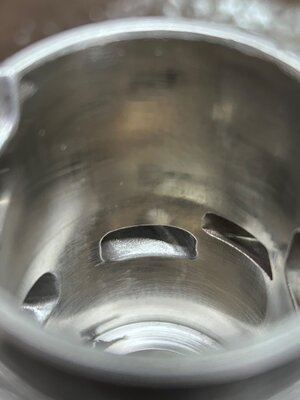

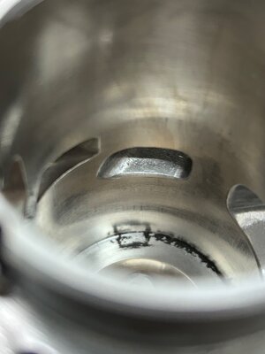

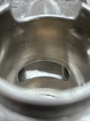

Only damage I could find is chipped plating from the bottom of the exhaust.

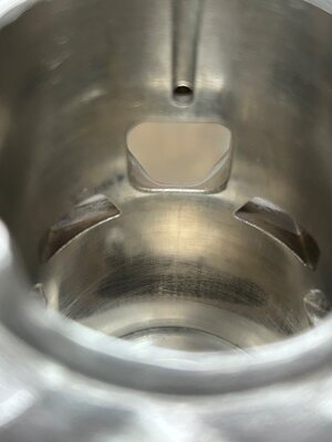

Cleaned up the cylinder and re-beveled the exhaust port
As caked on hardcore filthy as that case looks was the jug caked too? Id think it just ran hot, maybe a little lean on oil in the mix 1-2x and that may have pitted the piston :confundio1: Did the previous owner like to use race gas, that could have led to some piston degradation if the oil was not upped a littler too. Only other hypothesis is, was it use for short burst on a few super negative cold days and maybe the jug thermally expanded unevenly form hot on one side negative degree air on the other?....its a small engine I dont see temps playing much of an effect but ❓
No mysteries here.
The 562 is a pain in the ass to get the bevels on the port edges to lay down and create a nice clean bevel on. A serious pain in the ass. I've done a great many of them. What was found: A small sliver of plating had flaked off below the exhaust port. That piece living in there scuffed up the piston a little. I say a little because this saw has been used.....and used hard. A little touch up to that port.....and it's good to go for a another hard round of tree killing.
There are only a few guys that I have the confidence in to send work too.....and Kevin is one of them. He doesn't need that these days of course....but there was a time a few years back when I sent a hell of a lot of people his way. And not one was disappointed by the level of quality of his work.
To lay this to rest: This saw.....a 59cc Husqvarna has been running a 32" bar for years. And at worst it might could use a new piston? That's fughin impressive.

Yeah probably could’ve used a piston. I ran some scotchbrite over the whole thing and slipped it into the bore. Under .003” clearance still using feeler gauges. Ring was at .015” end gap
