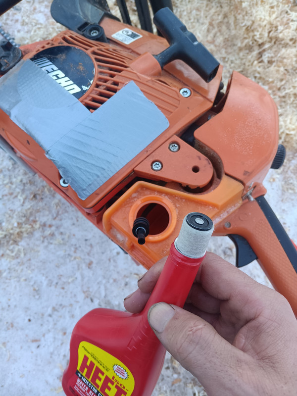

its crazy they do not offer them in Alaska.
Here in Interior Alaska, not having a carb heating element can be a challenge. Had a saw ice up somewhere in the metering of fuel, in the carb. 20 below zero, saw would run great, then bog in about 10 seconds of cutting. Had no place to thaw the saw out.
Thought maybe it was the felt in the fuel filter, so squeezed red bottle heat right through the fuel filter. Nope, still bogged. Smidgen of red bottle heet right in the fuel, and ice cleared out.
To keep more heat in the saws, beyond just the winter setting, gotta tape off some of the fly wheel.
During that below zero cold spell, my snowmobile carb iced up too. Wouldn't even spin the track without keeping the choke on. Again, red bottle heet cleared it right out.
People gripe about alcohol in gas, but u ain't doing sht up here, without red bottle heet. One ice crystal and you're fked.
Even with a heated carb, covering off 1/3-1/2 of the flywheel fins is still a must-do in hard below zero temps. Husq have nice bibs as an accessory.
It's insane, how badly a saw can get robbed of its proper operating temp, with a flywheel spinning 9-10k rpms in 20-30 below zero air.

Could bypass the red bottle heat and just run 89-91 octane oxygenated fuel in the real cold should do same thing. Seems heat is rarely need in a vehicle now since most states require e10 in cars. The rare occasion of needing heat is bad gas with water in it.
There is no alcohol in the gas up here. All we have is 87, 88 and 90 octane fuel.
All gas tanks breath in a sense. Even fresh fuel not contaminated with water. Moisture in the air builds up in a tank overtime until water forms.
I know you understand this, theres really no need to spell this out.
Right around September, everybody up here gets in the habit of getting that red bottle heet in the gas tanks before things ice up. Every auto parts store sells it by the box. Thousands of boxes of the stuff is sold in the winter up here.
I do run a few ounces per 5 gallons of red bottle heat in the winter chain saw gas. And of course a few ounces of it in every fill up on the snowmobile. Sometimes I forget, and theres always trouble when I do.
