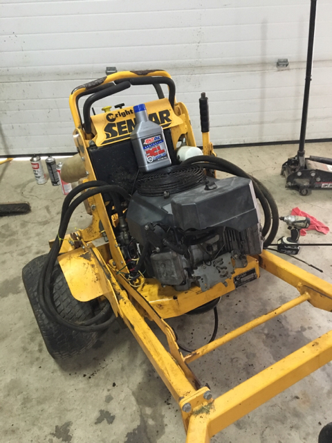

The Courage twins are good engines. The singles are junk. Briggs can be hit or miss but we have blown up a bunch of Briggs twins. The Courage twin for that price is an awesome deal.
So you would put these on a commercially used machine and expect it to hold up?
I also found this. http://www.smallenginesurplus.com/briggs-stratton-40h7775142-p-3297.html
I couldn't find any warranty info on the surplus center site. Is it factory warranty?
paragonbuilder
6:16 PM
384
Jan 2, 2016
9,229
33,871
Norwich, CT
Welp, neither of those will work. The motors are too wide for this mower...

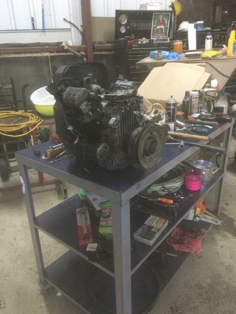

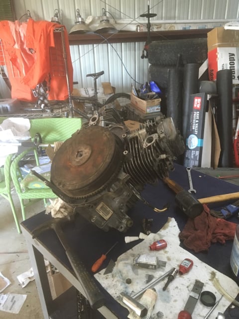

Ok so I decided to do a rebuild. Used crank and camshaft of the bay and gaskets and stuff came to $225. If it lasts a couple years I'll be happy!

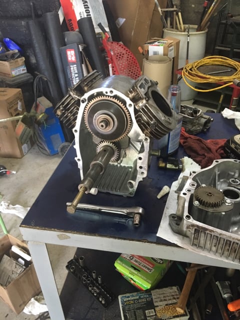

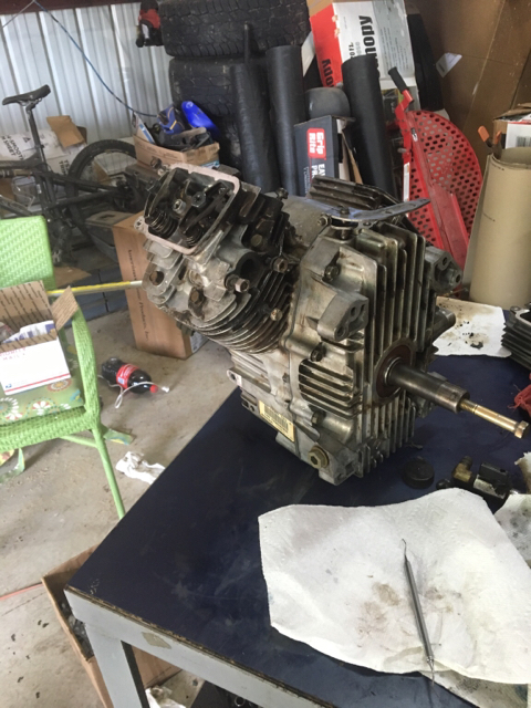

Going back together

I didn't put new rings in. I kept it minimal considering the fact it doesn't have bearings for the crank or cam. If I get a year or two I'll be happy. I've got $200 plus my time into it.
And it ran good on 1-1/2 cylinders so it should be better now.
