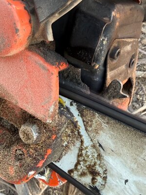

Go to to test out my 395 today and of course all the bar oil is running off the dawg instead of the bar tip. Jinxed…

Bar oiler hole not lining up with case oiler groove?
Or crud between the clamping surfaces.
