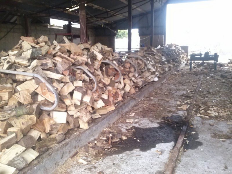

I have been using straight rapeseed for 8 years. I've used it in 33cc saws up to heavily ported 205 and 225psi racing saws, and hard working 288xp's and 044's. Never an issue. Never gums up. No bar issues. I do run my saws in Ireland, where the natives literally will complain if the weather tops 68*F, and it rarely freezes. It's basically between 40-65*F nearly all year. So keep that in mind. Though in the coldest conditions, I have seen tests in Canada show it works great - during the hottest of weather, it may not stick enough to the bar if it is big and making a lot of heat.

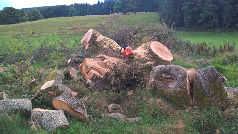

Look, Ma, no oil marks:
That log splitter sure leaks, tho :(

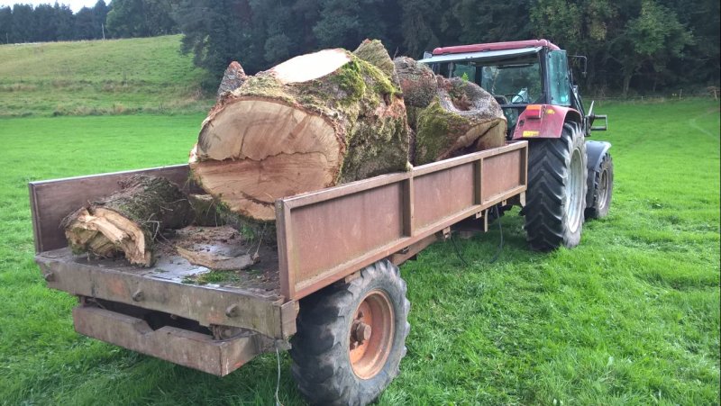

We bent the mounting arm lifting this piece for the camera ;(
