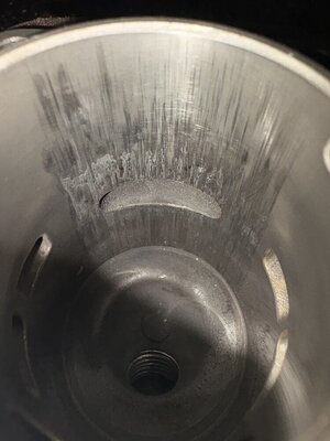

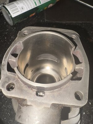

The cylinder might clean up using a few drops of muriatic acid on a qtip to remove the bulk of the aluminum transfer. And then try some sanding to see what all is left over. Can’t tell until you get the aluminum out of the way.

I have been working hard on this thing, still a couple of stubborn spots. Above the exhaust port feels more ‘scratched’ but not deep. I think it’s looking decent though. Still some finishing to do.
