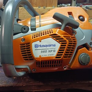

Some small mount shortblocks arrived in the US by mistake. They didn't even know it and shipped some of these instead of the large mount ones ordered for 562's. So, I called customer service to get it straightend out. They said they'd ship me the proper SB, and that they didn't want the wrong one back and that I should destroy it. Oh yeah, I'll destroy that right away. Figured I'd go the G route and harvested the heat parts from a wiped 562G. The icing was that for whatever reason, they actually had the 560XPG decal in stock! So that saw is correct other than I used an orange clutch cover.

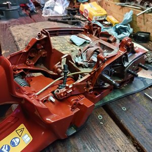

Got another NSM saw. (No such model). Had some Jonsered 2260 parts in stock that were obviously not not going to get used before I closed. So I thought, How about a large mount version? Had some 562 bones to work with. Unlike my Partner project, the only thing I needed to paint was the crankcase.
