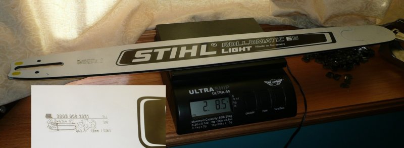

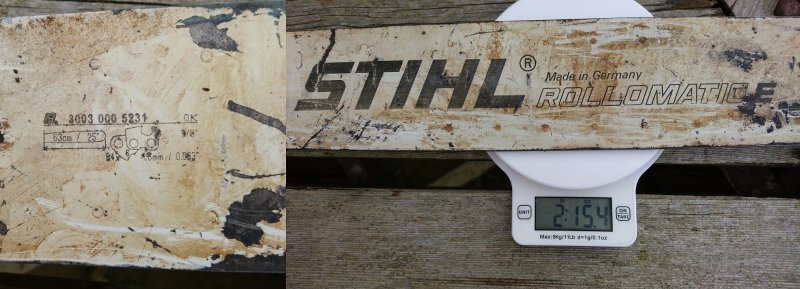

But I am familiar with the Oregon product, and I didn't like the treatment, either. However, there is a reason Oregon is not in this market as strong, aside from being made mainly in NA. It's the fact that they are not competitive. Europeans can get a Tsumura or Sugi lightweight bar for about 1/3 less the price the Oregon's and Stihl go for, and sometimes much less. That's sort of a secret most folks in NA aren't aware of. Lightweight Sugi and Tsumura bars are inflated in the NA market mainly due to the prices Stihl and Oregon ask for their light bars. I know, it seems cheeky, but these guys aren't the most cheeky. Stihl sells a light bar at premium prices that really is just a laminated bar with a standard tip. I don't really consider it a lightweight bar meant for robust use like the others. I mean, the actual laminated Stihl bars not masquerading as light bars last longer. So, it could be worse.
The relatively rare Stihl 25inch laminated bar:
It's weight:
Stihl 25 inch Light Bar:
What's the difference? I still have the laminated bar - and it's 8 years old now(and ran rapeseed oil it's entire life I might add)!
