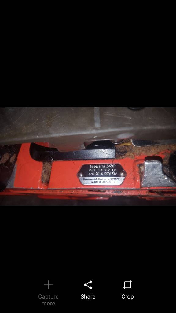

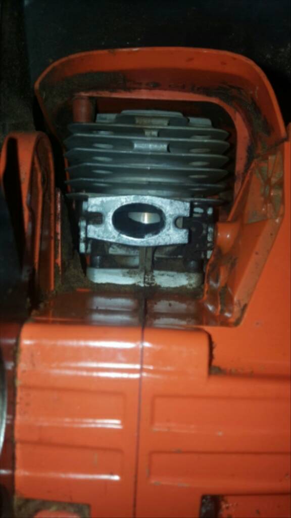

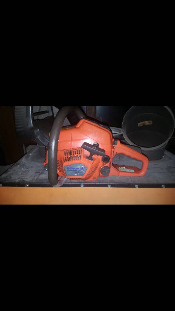

This is a good running saw just needs more power. Right now fell like a toy . I'm thinking of dropping cylinder raise compression to 180 psi also port cylinder and change port timing if need to . That were I'd like help . Also mufler mods. I want to build to use tried to trade off no body really wasn't interested so must not be a very popular saw. So anybody out there done any porting work on this saw would love to have your input. I'm not start on this project until I get some helpful information. Have a spare oem cylinder ordering a new piston rings. Stock husqvarna rings ok or should I check and see if caber makes rings for this saw. Thanks

Took this saw in on trade and i have a lot of chainsaw. Any from a 036 044 046 064 066 660 in the stihl line. The husqvarna 346xp 550xp and this turd of a saw I've tried to get rid of this saw for 2 years. My girlfriend won't even use this saw says it's a toy. I just fuqered I'm stuck with so time to do something with. I'm going to try something but don't know a lot about the xtorq cylinders . The way I see this if I don't improve it I'm not out of much.

I bought a brand new oem cylinder off eBay for 30 bucks that should of been a sine there. After looking at it. I don't know we're it was casted at but they done a damn good job . In die cast thin wall small cored area's are hard to do. I've worked for 2 very large die cast factories and they couldn't of casted this jug with that quality . To me looks like there not a lot you can do or unless weld and build up under transfer plates. Don't know going to thank about this but there always ebay .
