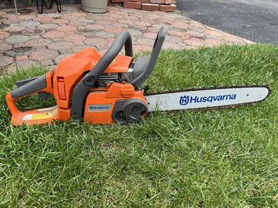

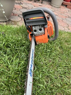

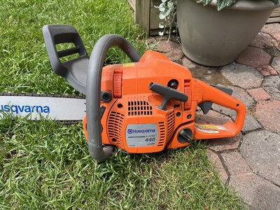

My father recently received a Husqvarna 440. He gave it to me to work on. He said the guy he got it from left it in his flooded basement for about 6+ hours. I personally have never worked on a water flooded saw, so I came here to ask if there was anything I should do beforehand/keep in mind before I start taking it apart and ordering parts

Does it pull over like it should? If water didn’t get into the intake and exhaust you should be fine. By the looks of the chain it didn’t. Pull the bar and chain, make sure the clutch isn’t frozen and check the clutch out. Check the sprocket on the bar.

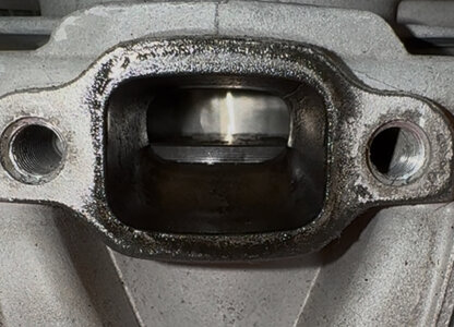

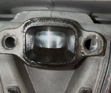

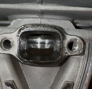

If you are concerned that water may have gotten into the cylinder, pull the plug and turn the saw upside down to see if any water comes out. You can spray WD-40 in there to help lubricate the cylinder and piston. You can always dump the fuel (in case water came in through the vent) and put fresh fuel and start it up.

Flood the cylinder with mix and shake then dump out. Refresh fuel in tank and try to start it. If it starts let it run to get good and warm to get all moisture out and the mix cleans any left over moisture out.
I’ve done this with flooded saws and saws that have been dropped into a lake with success. The sooner the better before any rust starts on the crank and bearings.
