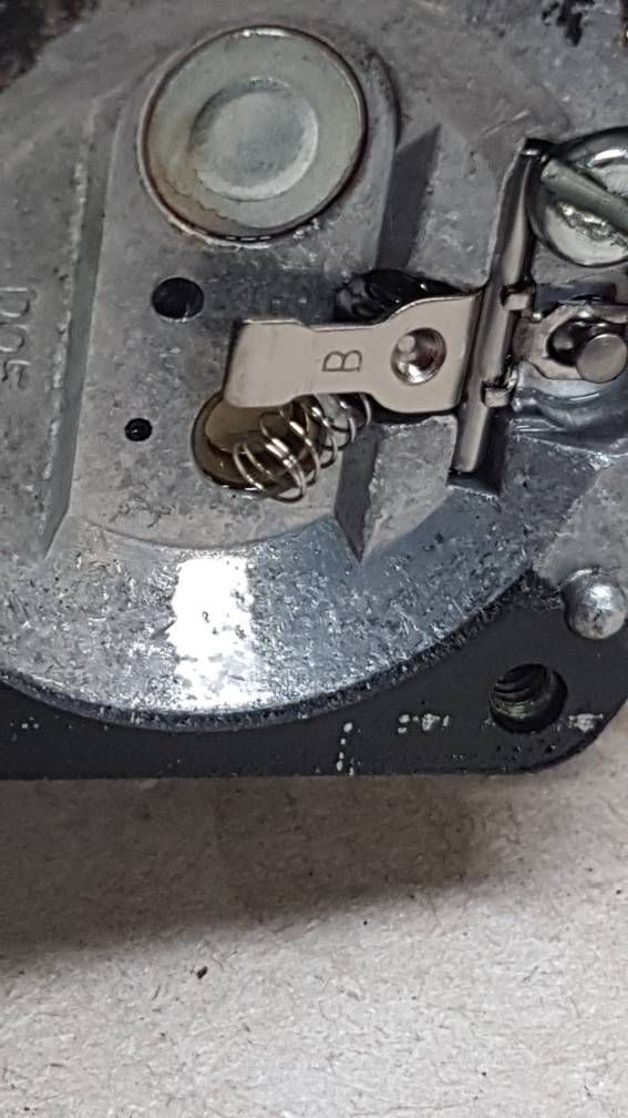

Found why saw kept running lean on top end , don't know how it ran at all

Once again forgive my ignorance, what is that a picture of? Part of the carburetor?
Yes needle valve, don't know how it ran , put it back together and forgot to check the height setting...
Floods easy , so I have to reset it today.
Saw is really clean , just have to get it tuned , rope needs replacing also ,

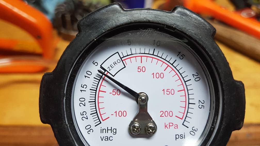

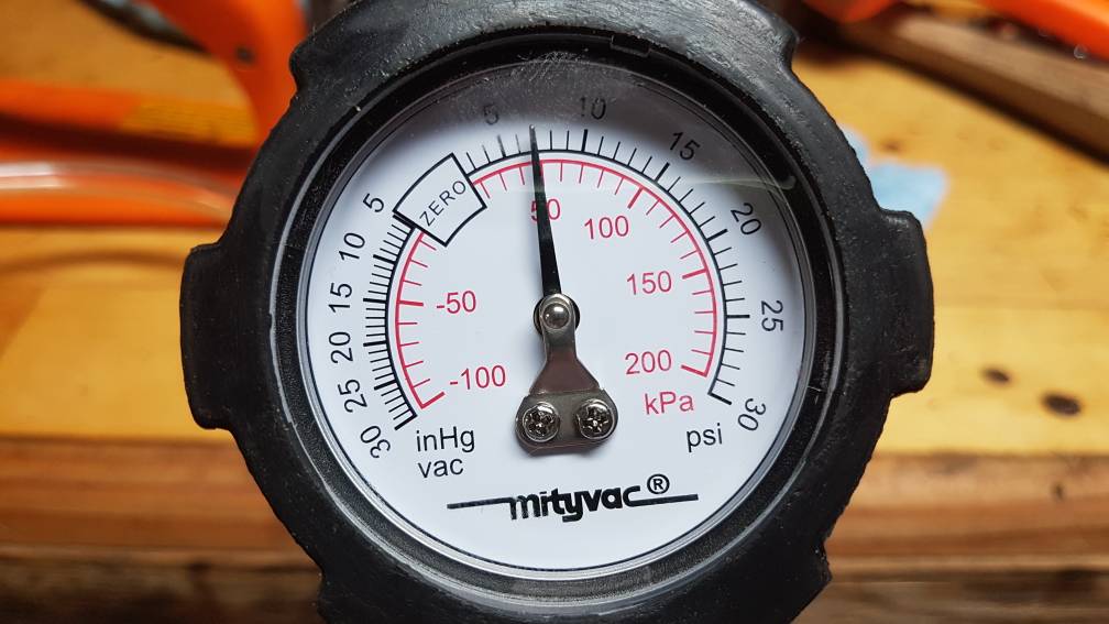

There should be a check valve on the tank end of that tank vent hose. It may be between the tank and the saw case. If you can pass air into the tank from that hose and not be able to draw any out it's OK .
Finally got mityvac and tested pressure, chain side seal bad ,
Hope I can find a seal
