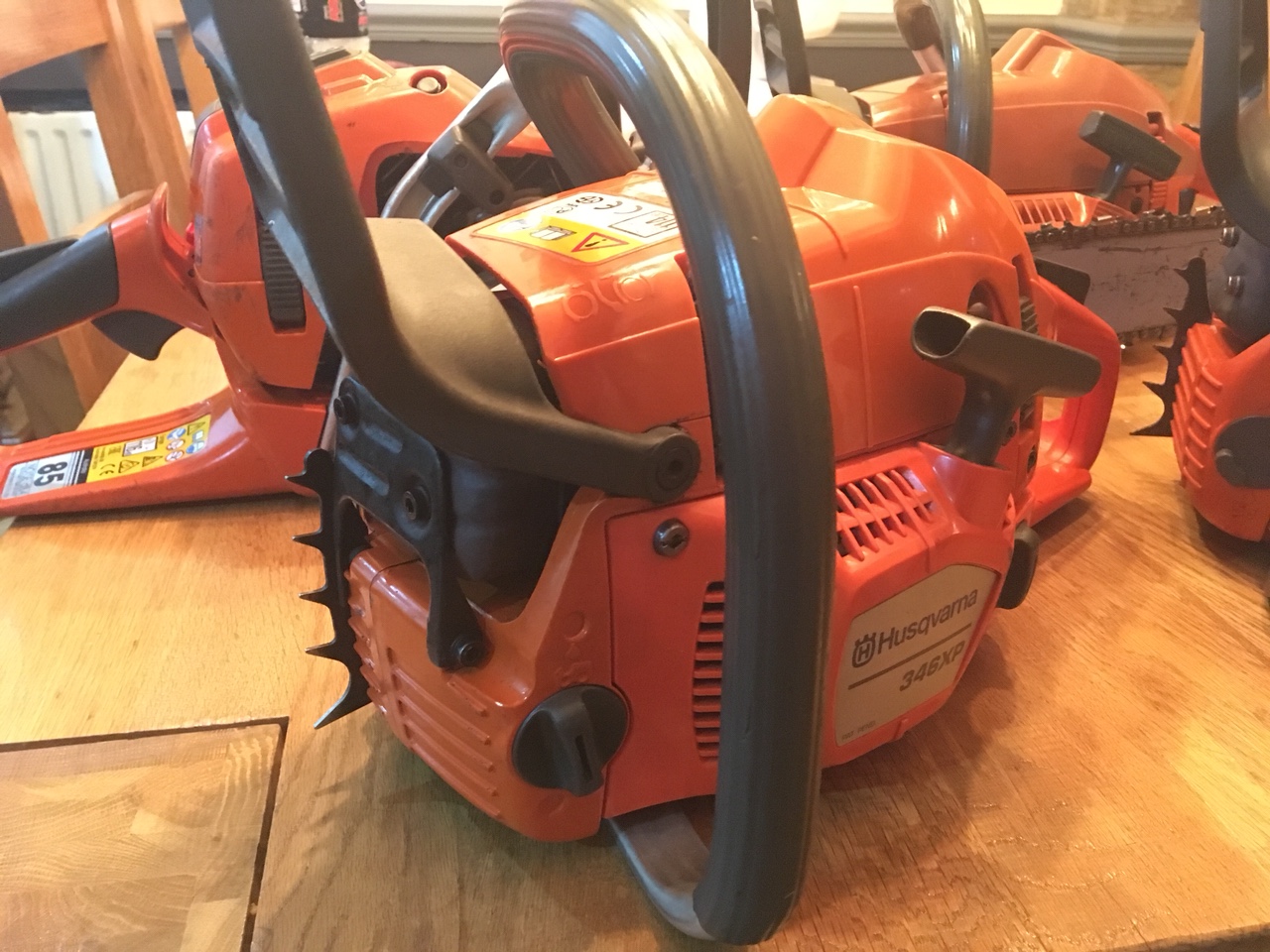

Sooo much knowledge, thanks TOR!! I have both a ruined OE piston and a 353 piston from a cylinder with the trans covers. I will try and find the time to see what will work on this saw.

don't keep them that close together... they will get pregnant and multiply like rabbits. make sure they don't know about each other, otherwise they get jealous
just fyi
:rolleyes:
This little 340 was a little saw hoe.. early last week it was just her and the 550 stud in my 50cc class, she slept around and these little things popped out..
