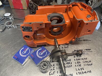

New here. Following with interest. Pictured (dirty as purchased two weeks ago) is my first ever Husqvarna chainsaw! Presently out for porting.
Big thanks to members srcarr52 and drf256 for your knowledge, now and in past threads, about these 262s. So informative.
