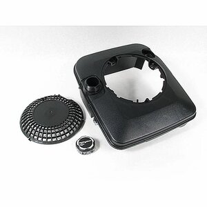

Hi all, seems that the damns chipmunks had a smorgasbord on my Splitter engine fuel tank.
So many holes, plastic melting probably not feasable.
Looking for part BS-699392
Cant find it anywhere, all state discontinued.
Maybe somebody has one on an old project engine laying around ?
Pic for referencs.

That's kind of an odd one, with the gas tank and shroud in one piece. All the Quantum engines I have seen have a separate tank and shroud setup, very common on lawnmowers. Can you retrofit the separate tank and shroud on your engine? Check out part number 699374. I pick up complete lawnmowers with engines for free on the side of the road all the time. A cheap/no cost option if it fits.
Around here they seem to like to chew up the caps on the tanks. Maybe our rodents are more connoisseur-like?

Realizing it could matter about the looks or resell ability. Or just simply prefering not to.
Any chance for mounting an off-board tank, like some of the commercial push mowers used to run? Of course it would take a little fabrication for a mounting bracket. Perhaps an old style rectangular tank like Tecumseh used on their horizontal engines?
