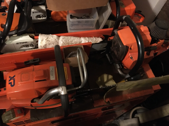

Pulled my carb and
451096CA-D75E-4FB9-9F9C-DBD3282A3CF2.jpeg 76275591-A7BC-4720-8431-683FD785785A.jpeg
Looks like it’s already blocked off, but they didn’t put the governor back in, is this ok!?!

Hard to tell whats going on there. What does it look like is in there to you? Jb? Seems like general practice is drop a Welch plug in and cinch the governor back in place to block it off. I have a different carb thats not stock without the governor port.

It looks like a tiny freeze plug. it tuned like it had a governor though, it four strokes hard, And if I turn of the eight screw and eighth of a turn in but it won’t even rev up it’s too lean
