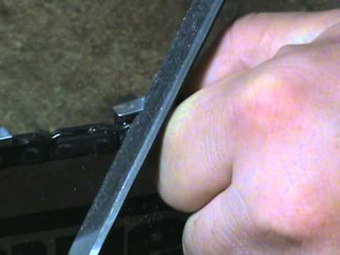

I think I'm done or give up with this chain. Continued first attempt at square filing. Figured why not try and tweak it some. A little side light on the Finland files - Either I'm too hard on them or might be wrong about the quality. Small cutting edge pieces are starting to break off right where they hit the corner and top plate. Now that I look at the pics - need to tune up and round off the rakers - I'm trying to set them at 22.

Don't give up! Looks like you don't have the file corner lined up with the cutter correctly.
I'm not saying I know what I'm doing but am going to blame some on the files. :rolleyes: I had a really rough time when the files started chipping - would cut then catch knocking pieces off and rounding the inside corner. Tried to correct and only got worse. I have too much time in that chain so will pull another file and be real nice with it. I'll get there eventually.
