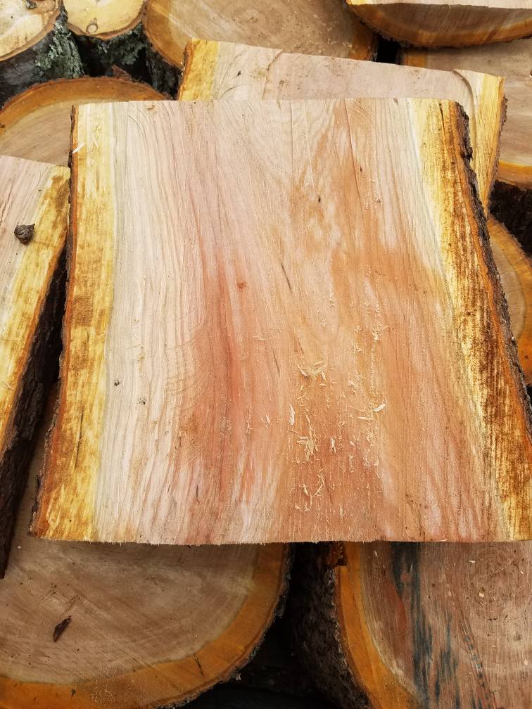

I finally did some hand milling of a nice straight piece of swamp cherry. I plan on trying to make a couple of hatchet handles and hammer handles. I will get a better judge after it dries out a little. Its basically heart wood. Probably about 1.5 inches thick.

Lol. I am more curious than anyone. The branch wood from cherry dries rock hard, so I figured I would try something in the name of science. It it doesn't work then back to the drawing board. Lol

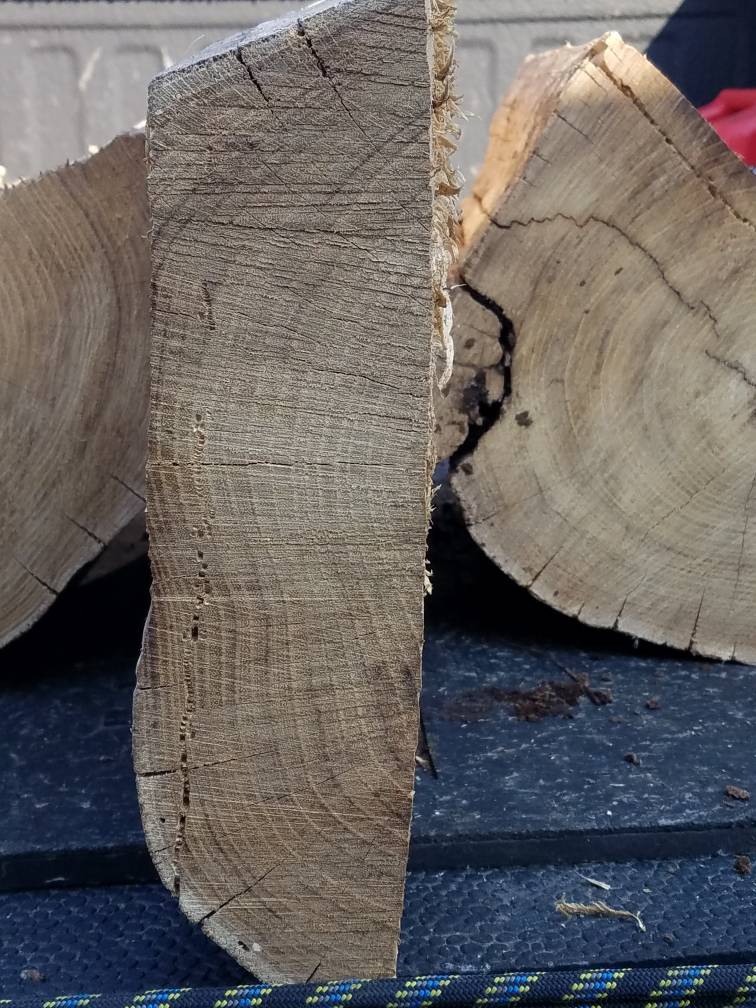

I cut up more of a large rock hard pin oak. I decided to try more milling. I figure I will try this too in Ax and Hatchet handles. This is already dried by 4 years or so. Any thoughts?
I think it’ll make fine handles. It’s ready to be worked. Hard and dry.
