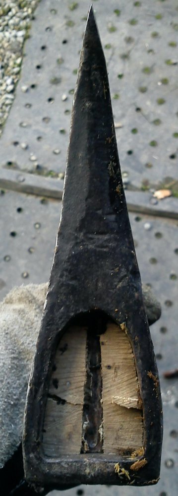

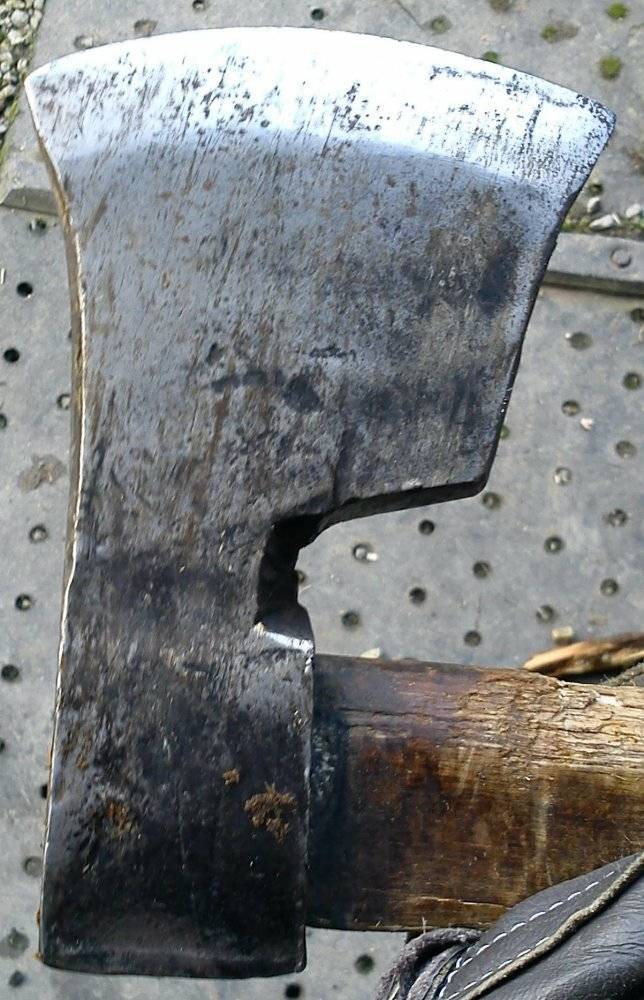

I smack a steel wedge in till the handle starts "singing", drill a hole through the wedge and secure it with a nail that I peen over on the exit side.
I drilled the ax head to have holes going through both sides and made a small countersink for the nails head and the peened side.
Works pretty well, no more loosing the wedge at the most inconvenient moment.
It seems to be a rather local design.
Try searching images on Google for "bosanska sjekira" , mine is very close to that design.
It seems that these can almost exclusively be had from blacksmiths.
Mine is closest to image number 2, Bosanska
The wide eye is somewhat of an issue when one needs to replace the handle as the handles sold in shops have a much narrower eye end.
I got mine in my teenage years, over two decades ago.

Has been reseated since.
Same old handle but new steel wedge driven in to max depth to secure the head.
Has seen a lot more work too, might need a sharpening soon.
New pictures
