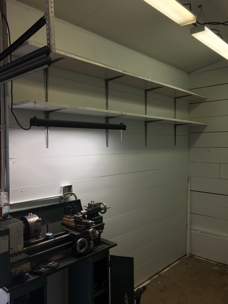

If you could recess a couple lights into the wall knee height you'd be surprised. Did that in some paint booths.
paragonbuilder
6:14 AM
384
Jan 2, 2016
9,229
33,871
Norwich, CT
A good start I think

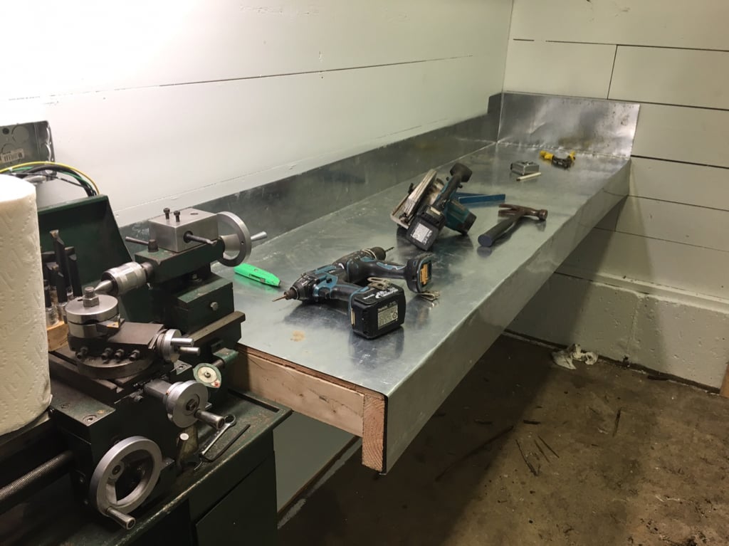

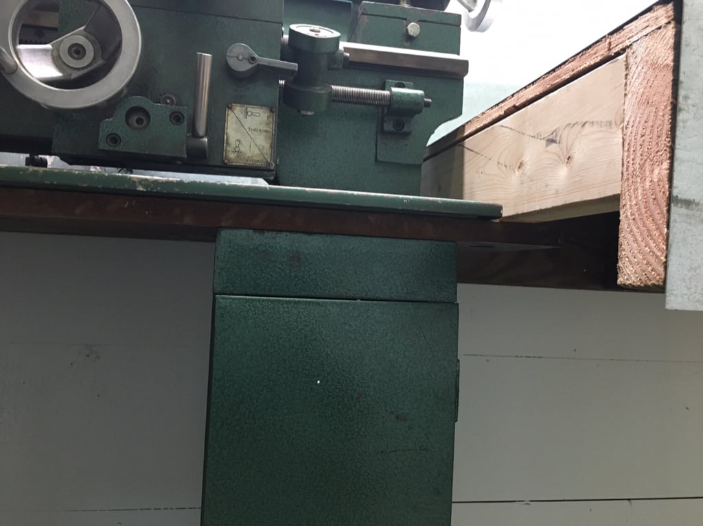

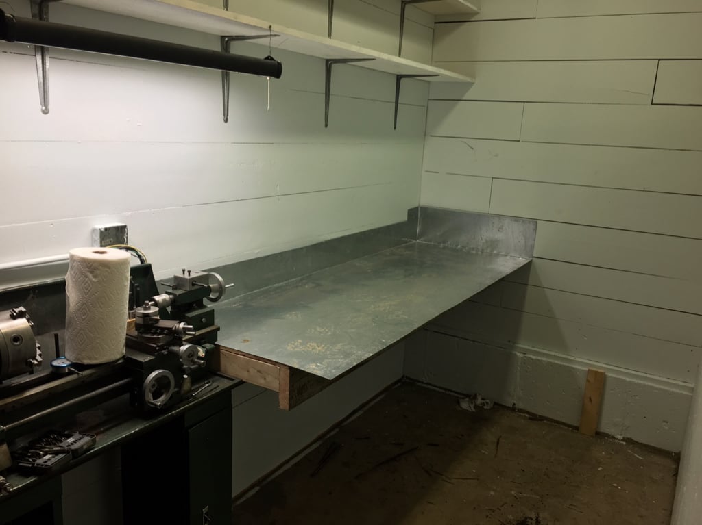

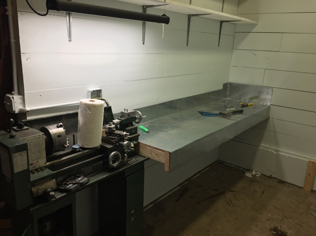

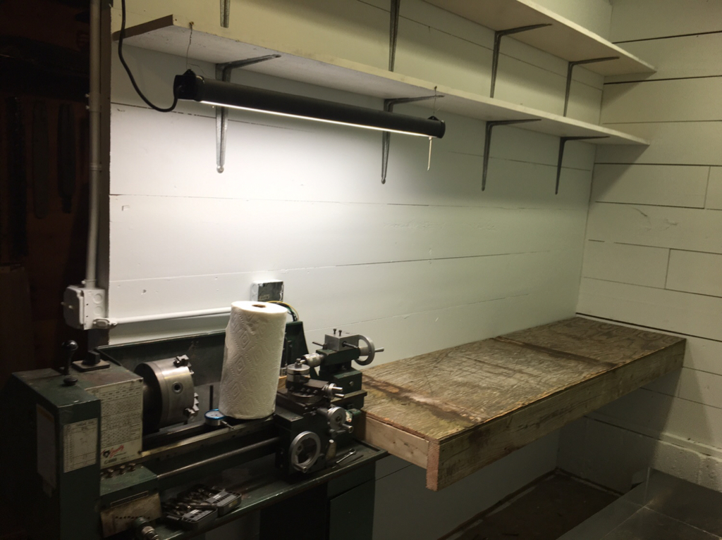

Used some stuff I had laying around to make a work bench.
Cut down a jobsite work table to fit.
Left side is supported by the 1" steel plate I used to stiffen the lathe.
Had some galvanized sheet
Didn't have a brake handy so I bent it with a straight edge, brute force and a hammer.
Finished product
I figure this will make it easy to clean and be pretty resilient.

You may never notice a difference, but having the bench bearing on the lathe could alter your cuts depending on how much weight is on the bench.
I was thinking it would take a hell of a lot of pressure to tweak that steel plate.
I can add a brace to keep the weight off just to be sure though.
thomas1
┌∩┐(◣_◢)┌∩┐
6:14 AM
322
865
4,782
Cristobal Colon
It takes a lot less than you'd think. Again, you may never notice it in actual use.
Fruecrue
certified hand catcher
6:14 AM
2417
Jan 4, 2017
4,391
21,697
Alden NY
I agree.
When I align a pump, could be 100 HP on a grouted steel frame, if I lean on the motor or kneel on the base, the dial indicator moves.

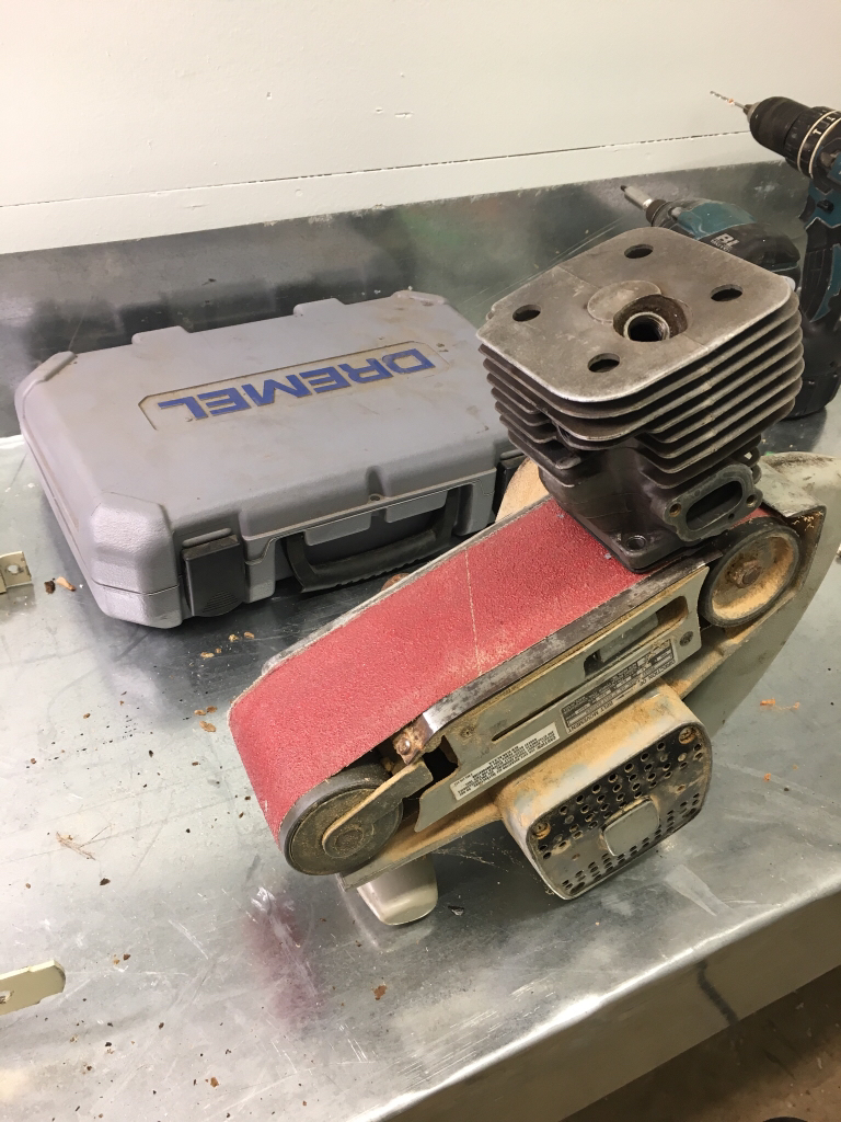

Nice work Jason ....how much do you charge for "porting" and stealering my perfectly usable clutch ?
The porting and stealering are on the house, it's the $250 shipping that gets you. That way you can't say you didn't get what you paid for, that is if you also paid extra for return shipping.
paragonbuilder
6:14 AM
384
Jan 2, 2016
9,229
33,871
Norwich, CT
I'm working on a spread sheet, it will be a varying scale based on number of posts the member has. [emoji849]
