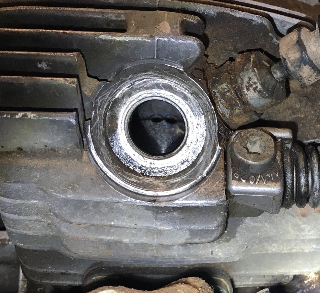

Look close where the piston crown meets the exhaust port roof.
I don’t think those two notches belong there.[emoji3166]
MS 261. Pumps 130.

Perhaps it's a failed attempt to emulate a piston prechamber like on some diesels .I don't think it will work .

Crome plating starting to peel where the cylinder wall was upset by the crude piston stop. Wouldn’t last Long with just a new piston & rings. [emoji90]
