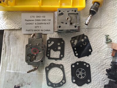

Hi, folks, having a FS94 carburetor RC2-S243B, try to replace the yellow plug (I believe it is one way check valve), see red circle from photo, unable to find part number from FS94 parts manual and lists. please anyone could help to identify the part number please.

Looking at the Zama Carb Manual (IPL), it appears to be the remote jet. Take a look at page 142, reference number 12 for the RC1/RC2 type carb. The part remote jet part number here is on the next page and is 0070114 and 0070116 (depending if it is the M47 or M48 - I am not sure in the difference).

This is a non-serviceable check valve and retainer. You will need a replacement pump body assembly.
