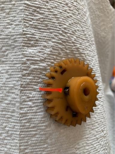

Sometimes the "decompression" spring on the cam warbles stuck and wallah...take it apart and check the plastic cam follower. Very simple engines. Usually the valves or the cam...post back with followings.

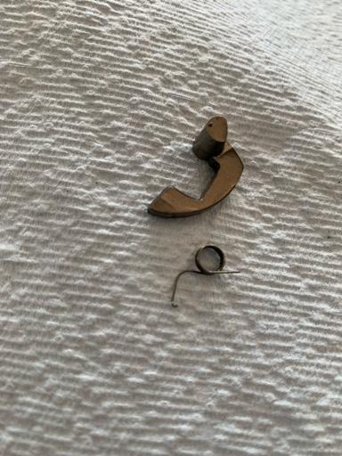

Deleted the ‘cam bump thingy’ and spring.

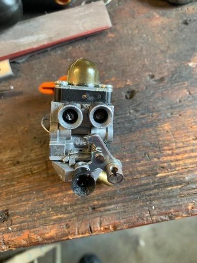

Now it starts much more reliably but the carb (damn Zama to hell !!) isn’t at a happy place.

The culprit:
Discarded this:

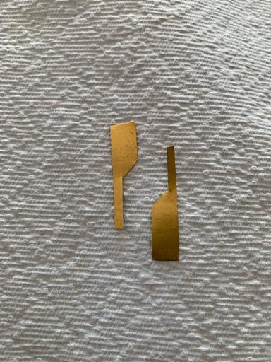

Had to make this to adjust the valve lash:
.003” brass shim stock. Made a two-fer. The narrow one worked. [emoji108]
Cant get the Zama to pass fuel. Buy a replacement off evilbay, we will.

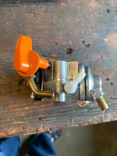

Can someone tell me where to set the high and low mixture screws?
I can get it to start but it starves out for fuel and dies.
At least I think it’s a fuel issue. [emoji848]

Depends on the carburetor you have. Model description?
67L36Driver
9:44 AM
596
9,400
39,363
Zama C1Q
S174
4180/11A
805A

Broke down and had the dealer fix it.
The original carb was plugged up and the China copy was junk.
A new Stihl carb and, most importantly, a new fuel tank pick up hose solved the problem.
$125 brought our four mix education to a finish.

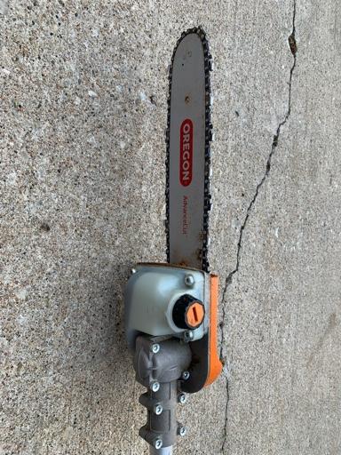

With this on the end, we have us a shorty pole saw. [emoji108]
