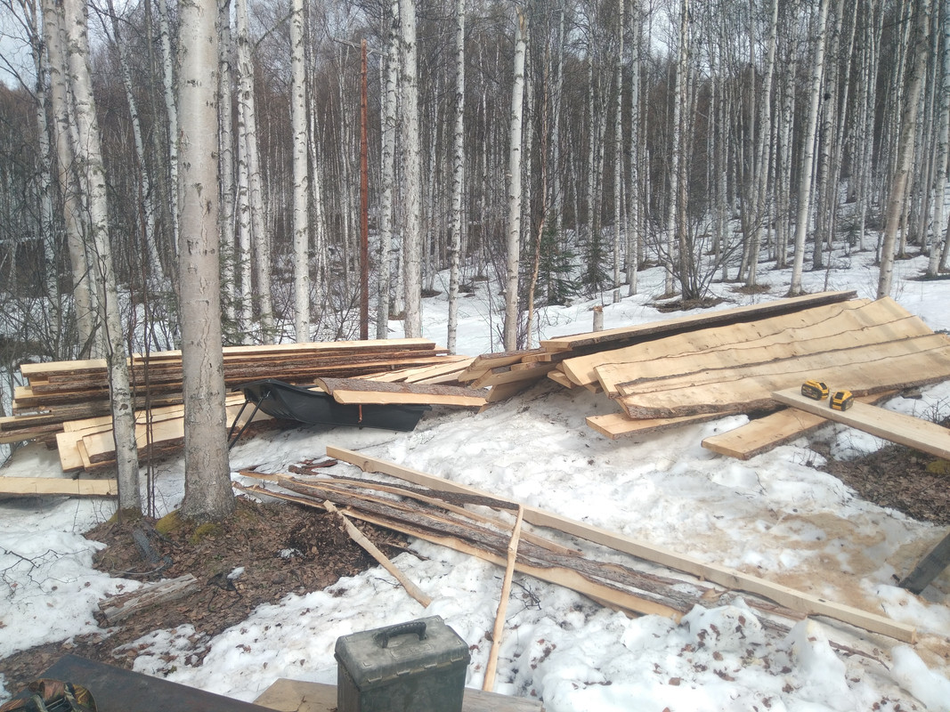

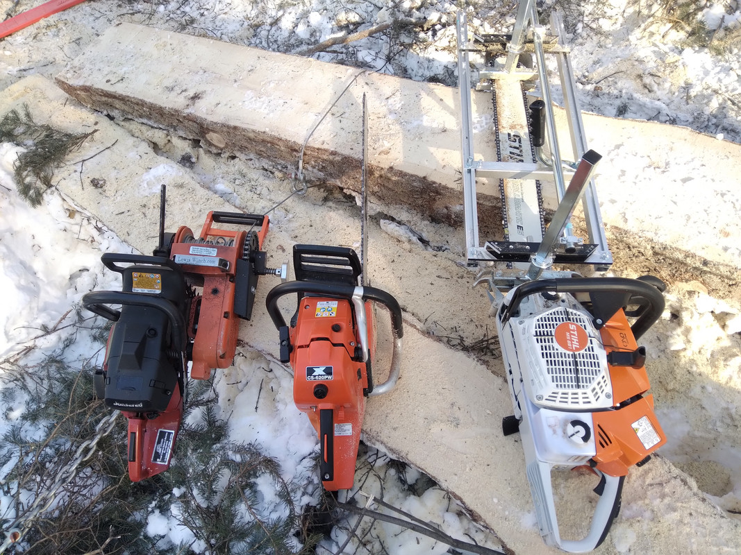

Put two years of milling 16 ft long spruce and alaskan birch with a 660. Its decent with spruce, but falls flat on its face in hardwoods, no low-end torque. Stingy oiler, and not worth the effort of upgrading to high output oiler. The plastic oiler gear is not very well protected from debris either.
An 881 has been marginally better, but still lacks low-end torque. THE milling saw, is an echo cs 1201. King of the .404....
