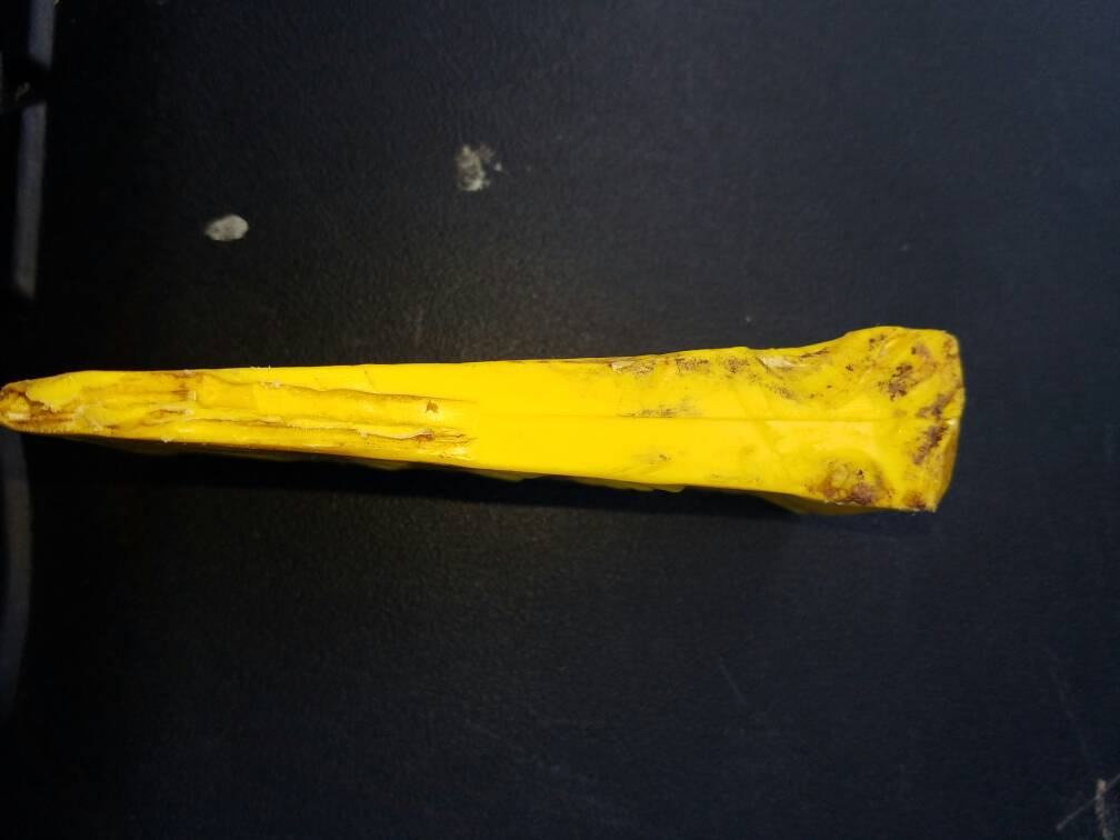

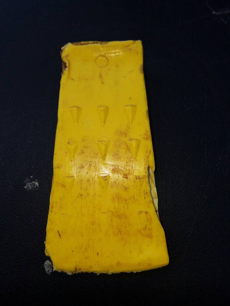

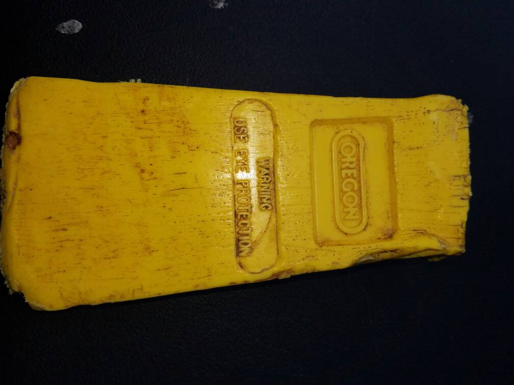

This is a photo of the Oregon wedge I have used for a loooong time. I hit it s few times, smashed it with a 3lb hammer and dropped a lot of trees with it.

This feller doesn't do a lot of felling, the Oregon ones been good to me that I purchased locally. Seems like a lot of people like the K&H redheads, maybe I'll put them in with an order some day and give them a try, as double stacking the Oregon ones seemed very difficult and my only complaint.
