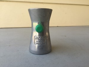

A powder trickler is a really nice tool also.
I never worry about double chargeing a case. I drop the powder into the scale pan of the digital scale. Trickle in if needed, pour into the funnel and insert the bullet right then and there.

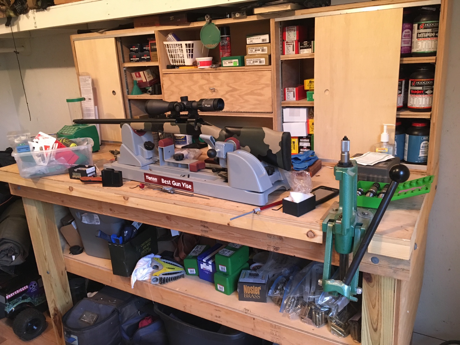

A lot of what I have is newer versions of what you have and I've been reloading for 40 years.
I've gone to progressive presses for everything I load in quantity. I use single stage presses and weigh every charge for hunting ammo, .308 & .223 target loads, as well as handgun loads for the big bores.
A few years ago I tried wet tumbling. It works a lot better and I don't have near the mess.
I use a Dillon super swage for removing the crimp on primer pockets. I process a lot of military brass and it makes the job a lot quicker. I still have and use a primer pocket uniforming tool on small batches.
I also use a drop in case gauge on every case before I load it for the first time. Military weapons are really hard on brass.
I have a maximum length gauge but also utilize a good set of calipers. I use a micrometer, for measuring bullet diameter, case head expansion and several other things.
When I started reloading, I only had the bare necessities. Over the years, I seem to have accumulated a bit more.
Here's a couple pics of my little rat hole.
