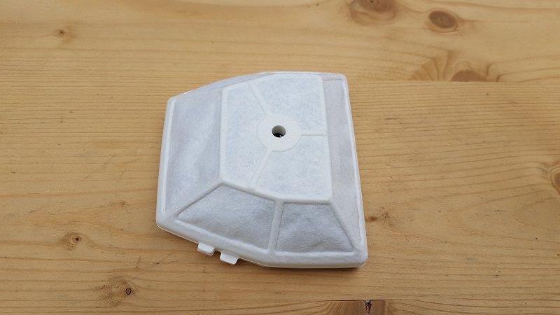

BTW - Thats the Airfilter from a Echo 620SX. Looks like a joke, or?

On the 590 and 600/620 series i put a oring on the air horn where the filter meets the base
I had no further issues in the 7 year's i cut with it.

Filter to air horn connection is the issue with the 501. I removed the 'gasket' and wrapped a couple wraps of teflon tape around the channel, then put the gasket back on. Very tight fit. Only fines I'm seeing now are what can get through the Shindaiwa mesh filter material. Had been my only complaint with the saw. Before, the entire air horn would be caked with fines.

This is an optional mesh filter for the 590/600/620. Sometimes the nylon filters will actually do a better job of filtering because of the lower overall restriction. Also put some heavy grease on the seam between the two filter halves. I agree, the air filter is the weak spot on these saws but thankfully on the 620 it has a great prefiltering setup. Despite this weakness, the engines are the most reliable that I've seen. They go for thousands of hours: we've had some in commercial service for over 8 years non-stop. 501.PNG

I need to put a felt filter back on and see if the fines completely disappear. I'm partial to the nylon due to easy cleaning and long life. They'll last forever so long as you don't poke a hole in them it seems. Have both versions for almost all my junk. Have not run across any mesh for my CS3400 or the Makimar 6100 <---(best filter setup of any of my saws).

This is an optional mesh filter for the 590/600/620. Sometimes the nylon filters will actually do a better job of filtering because of the lower overall restriction. Also put some heavy grease on the seam between the two filter halves. I agree, the air filter is the weak spot on these saws but thankfully on the 620 it has a great prefiltering setup. Despite this weakness, the engines are the most reliable that I've seen. They go for thousands of hours: we've had some in commercial service for over 8 years non-stop. [...]
Thank you. Those new nylon filters looks like the filter Husqvarna is using. If the have the correct size, no beach dust will go behind. I will male some photos in the future of the intake, so that you guys believe me.

Yep, the oem 620/590 filter is sufficient. I've had no problem with them, and I cut alot of dry fire killed spruce.
Well than we have had made other experience. I never cut down wood who was on fire. So I cant tell anything about it. But I can tell you about those very thin beech particals who can made it throw the filter and get in the intake. And that should be.
By the way: Thats how a 261 after a whole day in beech looks. Its not rough stuff, its very thin stuff that the filter need to blocked. The most part, nobody think about is, is that a HD2 Filter or same looking filters have a much bigger surface for letting air in befor they need to be clean completely. Thats why its so important to my to get the new HD Echo Filter an every so I probably can. And no, all the stuff in the filter is from one 8-10h working day. I clean my filters every day with pressured air.
Greetings

I designed and 3d printed an air filter for my CS-590 about four years ago and it works great. It is similar to, but IMHO better than, the Red Beard kit. I tried a bunch of different filaments and filters before finally settling on Polyethylene for the frame (its what plastic gas cans are made of) and a 2 stage oiled foam filter (20ppi outer with 65ppi inner).
I'd be more than happy to post the CAD/ STL files for anyone interested in making their own. There are a number of 3D printing services that will print the parts for people that don't have a 3D printer (not sure the price but it shouldn't be much) and universal filter sheets are only 10-12$. You could also have the parts machined in aluminum or carbon fiber but that is obviously more expensive. Eventually I'd like to get one made it titanium but that's not happening any time soon

The round automotive style filters used on the older Echo saws rock, they never should have moved away from them. That being said, I seal up the air filter to carb box with wheel bearing grease on my CS-500P and 501P and haven't had any problems. The flywheel fan does seem to do a good job of spinning out most of the dust and chips on all my Echoes except the old school design CS-303T. It does get dirty pretty fast due to the filter being on the very front and vented directly to atmosphere.
