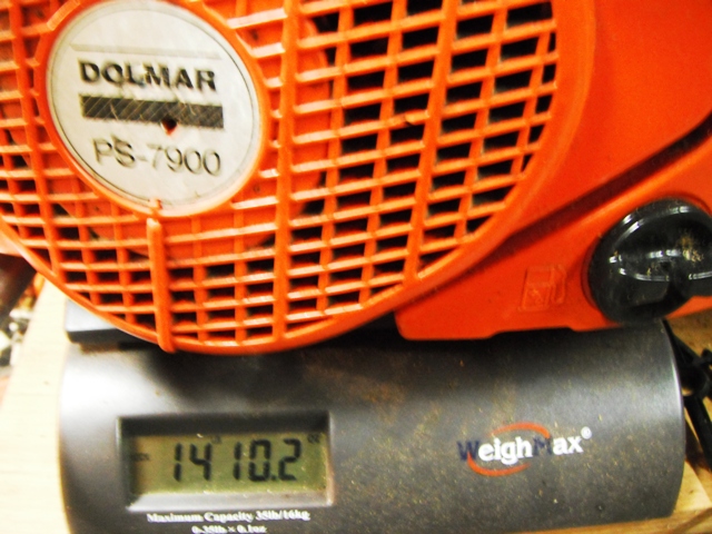

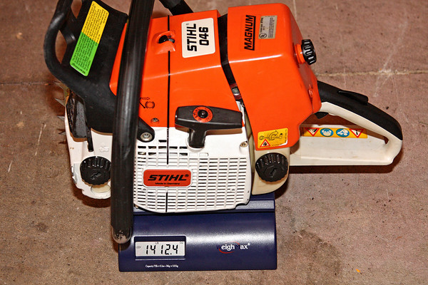

BTW, the Dolmar 7900 is the main reason I started the chainsaw weight gallery. One day @sawfun and I were chillin in Yamhill, Oregon, sat in front of a fat Douglas Fir log with a 372, an 046, a 7900, and his old 044. We were about to test them side by side(and we were both impressed by all of them). I then said to him, no freakin way that 7900 weighs a pound less than my 046. They felt nearly identical in weight. But everyone on the AS forums was saying it weighed 13.6 lbs. I shut them up about that in short order.
https://pbase.com/wyk/unofficial_chainsaw_weight_gallery
That day spawns fond memories for me. I have since sold that 7900 as I had ran it side by side with a strong running stock ms460 and found that I liked the Stihl better, with the exception of the AV. I now have a stock early 046 that cut circles around that 460 and would have done so to the 7900 as well. As far as weight goes, When I weighed that 7900, it weighed the exact same as my 460, 14.6 lbs empty, both with dual dogs and half wrap. Maybe Dolmar removed the dogs and clutch cover to get the 13.9 weight? I dunno, but mine wasn't at that number. I believe the 7900 balances just slightly better than the Stihl. We had an early 064 out to if memory serves, and with a 32" bar it was stronger than the 7900 with 28" bar. I've now found I prefer my 372's, though ported, to either the 7900 or 046. The Husky balances and oils much better than either of the other two saws, especially with a 36" bar. And while I haven't ever needed them, I carry the extra muffler bolts I've been warned to, as the penalty for running the seemingly dreaded Husky. lol

The saw weight comments and comparisons are worse than arguments what oil to use at what ratio.
Just so You know I have no clue how much xx lbs is and I had to look it up on Google.
For example:
13.6lbs = 6.17kg
14.6lbs = 6.62kg
To me in lbs the difference looks and sounds huge, shown in kg the difference is at 0.45kg barely worth mentioning.
If You can feel the weight difference of under 1/2kg than You must be able to feel the need to refuel Your saws tanks BEFORE the engine or chain tell You so, considering that fuel & oil tank carry over 1kg of fluids combined (Dolmar PS-7900, 0.75 + 0.42 liter).
Some of You guys must be really sensitive.
