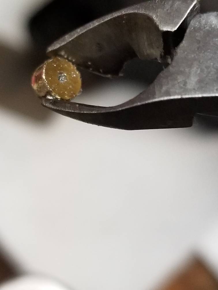

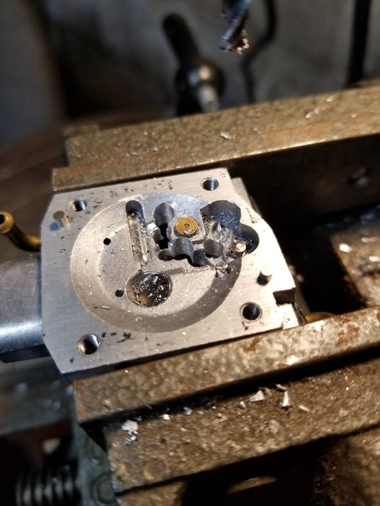

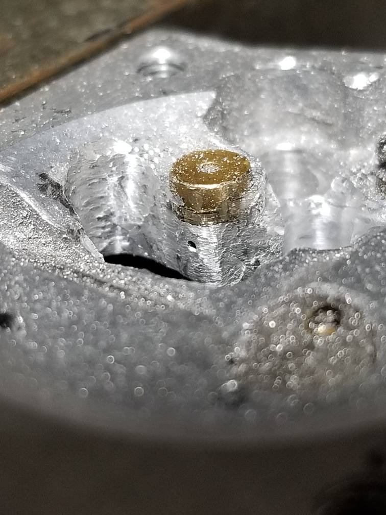

I'm building a post that adds to the poleman tutorial. I've been up against the carb mod curve.
This is the jet you pull with its membrane intact. I haven't seen a pic posted yet.
Believe it or not it's easier to just drill the old jet, and find a salvage carb to discect for the jet. You are drilling it so orifice size does not matter. They come out pretty easy.
