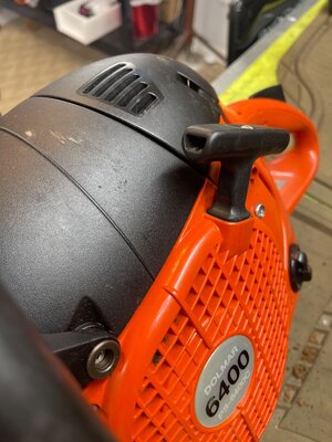

This thread needs a bump. Been months since the last post, and these saws are too good, and too much fun, to let this thread die.

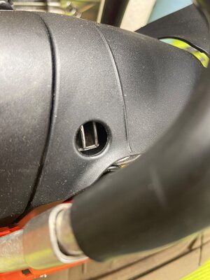

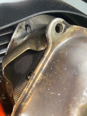

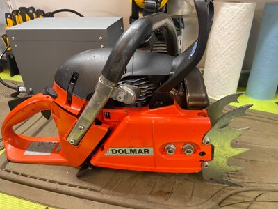

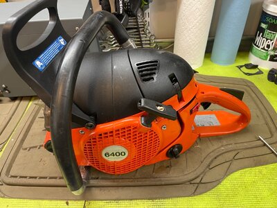

Here’s a 6400 with a closed port Solo 665 top end, so it’s now a 64cc closed port.
The 6400 piston is still used, as the height from pin to top of piston is slightly taller than on the Solo piston, so less had to be taken off the base to get squish around .020”.
I feel like this is how these saws should have been to start with, but this will be a fun one.
As you can see I’ve left everything alone, and just plugged the decomp. The top cover is untouched.
I still have to gut the muffler, and slot the upper mount holes.
Props to @huskihl for doing the machine work on the base for me.
This saw has been together for a couple of years now, but I haven’t gotten around to doing the last touches to get it ready.
Edit: I had the pistons mistaken. The Dolmar piston is taller than the Solo piston. @David Young Thanks for catching my mistake.

I feel like I am missing something here. The Dolmar has a 1mm shorter stroke so i understand that the base needs to be cut but don't understand the benefit of the Dolmar piston in the solo cylinder. must be the dimensions are different? do you have any pics side by side?
SOS Ridgerider
Muffler Modded Member
12:44 PM
1222
Apr 30, 2016
2,553
15,338
Central CT
From what I recall, the pistons are almost the same, except for the slight height difference.
Wait a minute... I feel like I have it backwards, and that the Dolmar piston is taller, which would make a lot more sense why I did it this way. Less would have to be taken off the base that way, which was the whole point.
It's been over 2 years since I messed with this, and my memory is, obviously, pretty much stellar. Plus I'm clearly a genius :facepalm:
I can probably get a side by side pic. I'm sure I have pistons for both kicking around somewhere.
I believe you're correct David, and I have it backwards. I edited my original post.

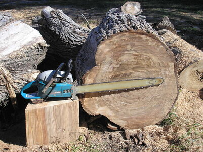

I suppose so. My "outlier" keeps going and going:
1751496991597.jpegI love this saw. I replaced the top end with a big bore kit. That made it a monster. The 32" bar and chain is shown here.
