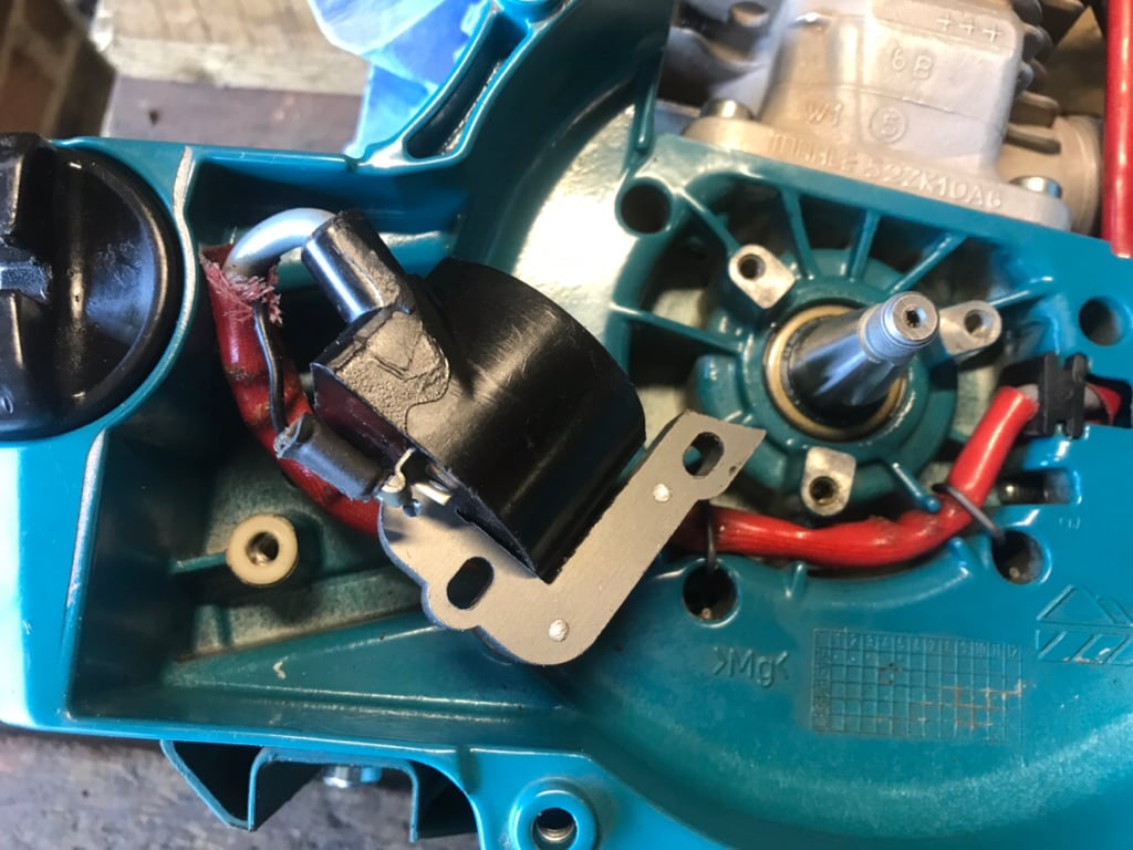

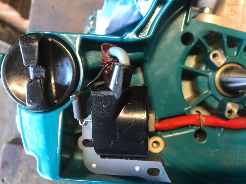

Can someone help me fitting a 272 coil. Can’t seem to juggle the wires in. Have I got the right coil? Do I need to pull through some more wire?
Thanks in advance
Thanks in advance
You’ll need a longer plug wire than stock. Fit the coil first, then route your wire and cut to length.
Also, you won’t be using the flywheel key. Timing is way different
Thanks for the info.
Does the wire still need to go under the coil in the same way, just carry on up and over? What do you do about the 90° bend into the coil?
Sorry for being simple, but electrics are not my thing, what type/ gauge wire will I need?
I have the diagram for flywheel set up. The key has sheared off mine so thought might as well do the 272 coil mod, starting to wonder if it’s worth the effort [emoji849]
Yup, bend her tight and stick it under
