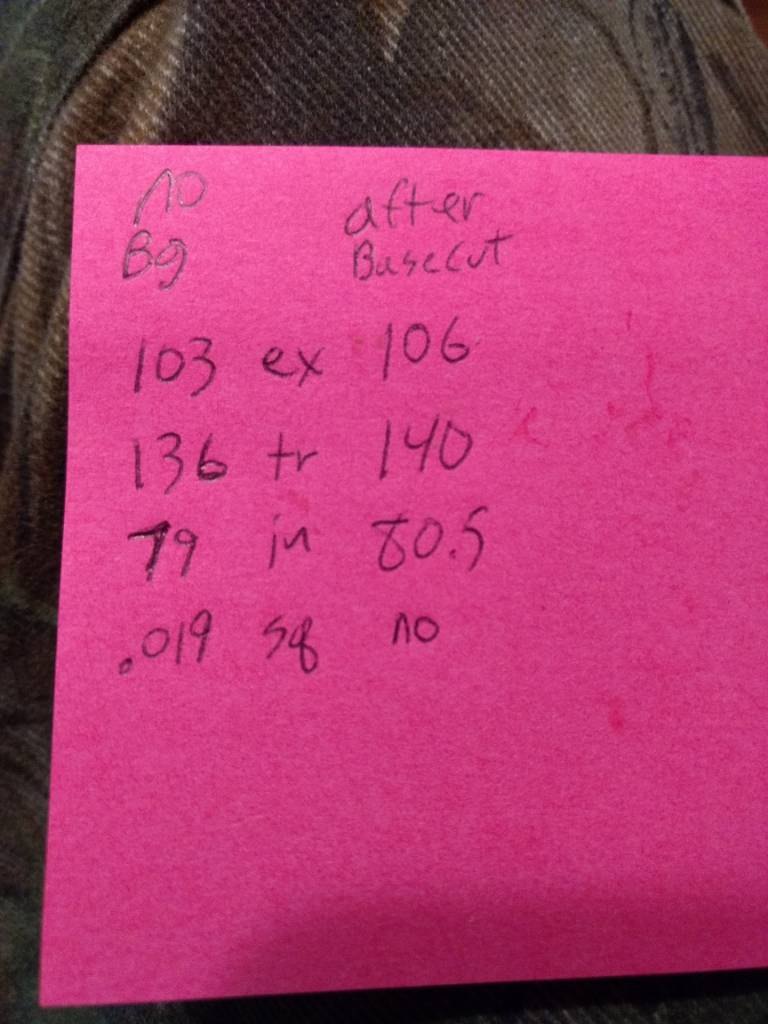

Now I need to decide on some timing numbers for this 6401/7901 conversion...

This is where I'm at.
Cut the squish by hand back to .019
I'd try to get the exhaust to 102, primary trans 128, secondaries 132 intake 80 for a long bar. Short bar I'd move the ex and trans up 4°
I really need to suck it up and get a 90° foredom...
Thanks for the input.
Hopefully I'll have it done for MMWS#4 gtg,
What do you think of this for all around:
100
128/132
85
Im not 100% sure where I'm at yet the base/squish is getting cut now.
