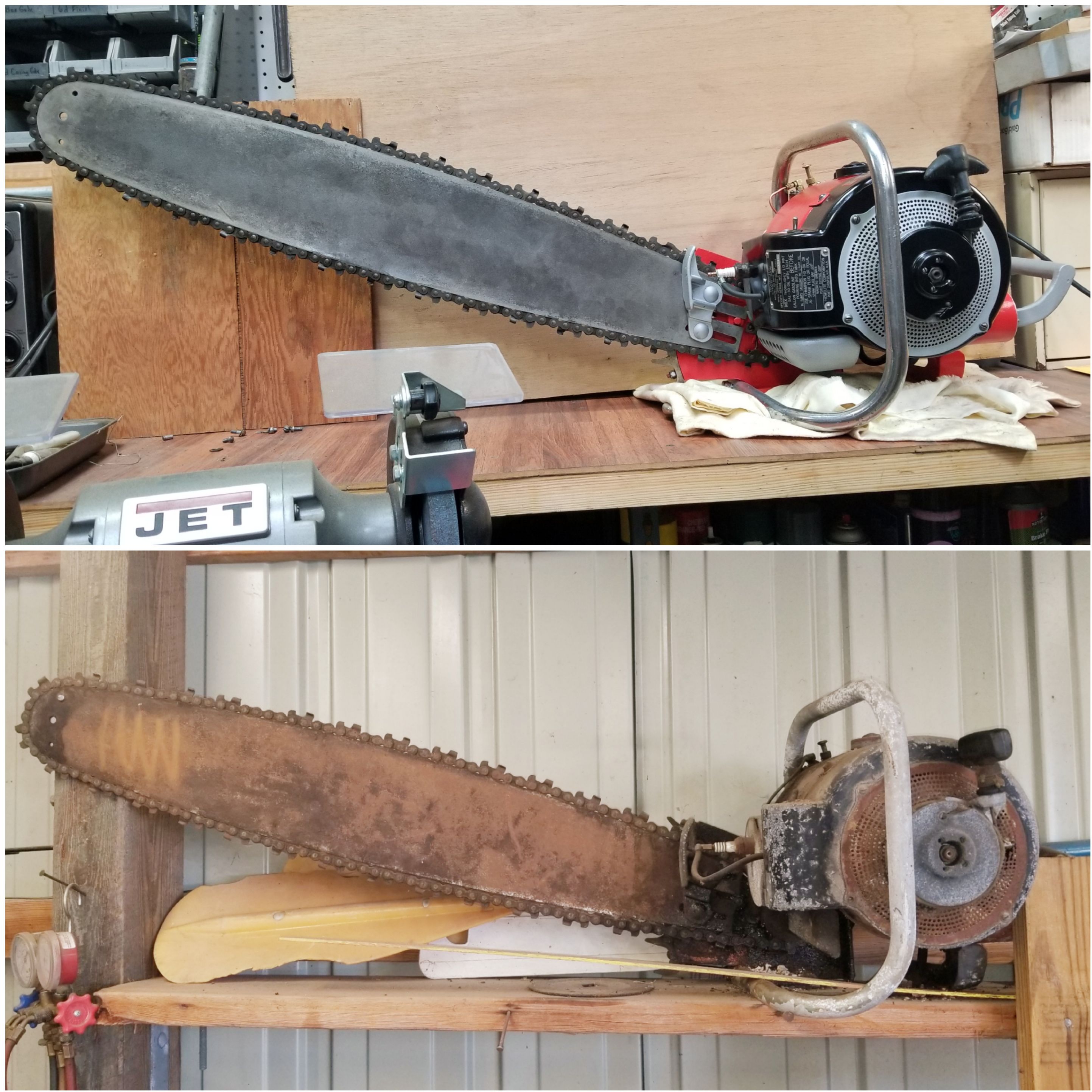

I got the saw almost all back together.. I am working on cleaning the bar. I am using a wire wheel on it. I really wanted to do the washing soda and battery charger trick but can't come up with something to hold the bar.
I did that to an old crusty bench vise. You don't have to hold the bar, just stick it in the water/washing soda concoction. You need a piece of sacraficial steel and a battery charger. It's super easy.
Sounds like you are looking for a plastic or glass container big enough to hold the bar in the electrolysis solution? Not sure how big your bar is, but some large containers could include: plastic gutter or drain sections from a home store; large Rubbermaid style totes; clear plastic boxes sold at craft stores for storing rolls of gift wrap; a fiberglass bath tub; kiddie pool; a plastic kayak; etc. Or, you could build a shallow frame with 2X4s and line it with several layers of heavy plastic.

I ran this bar through my electrolytic bath.
