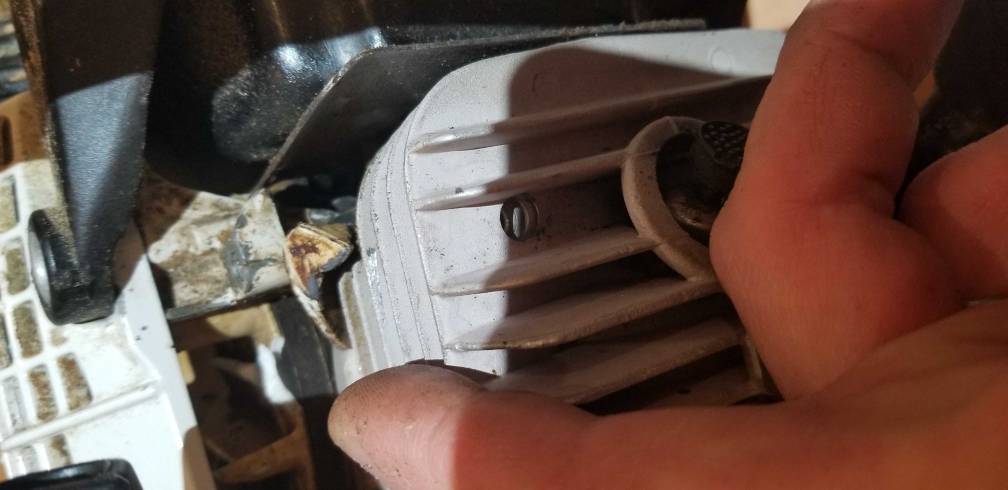

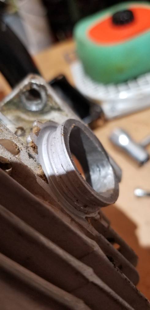

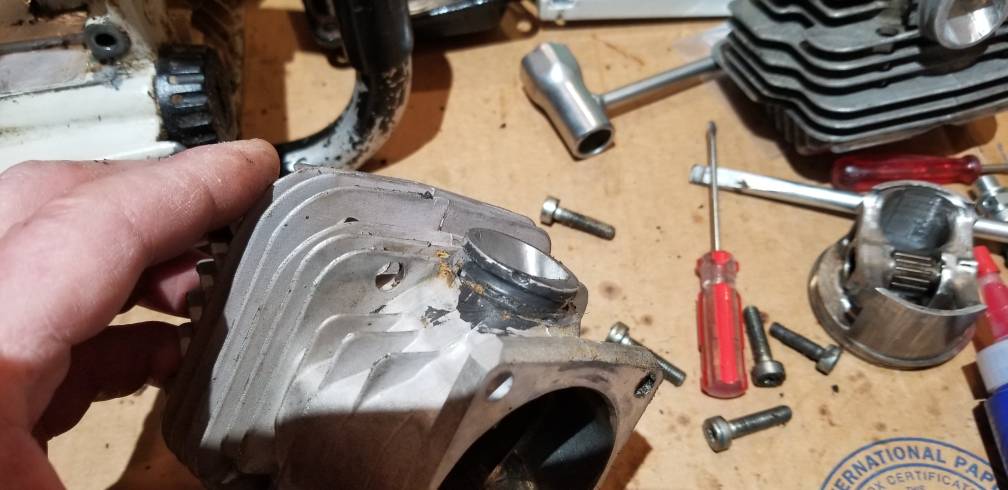

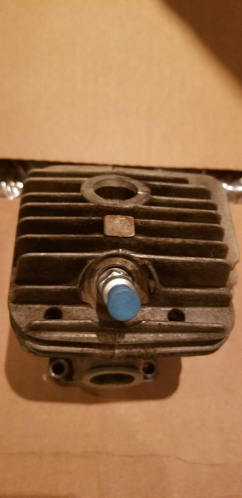

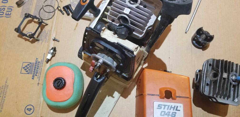

Top swap!
Going back to stock 046.
Gonna get hands in on this one so JMS Jason doesn't leave me victim to his works.

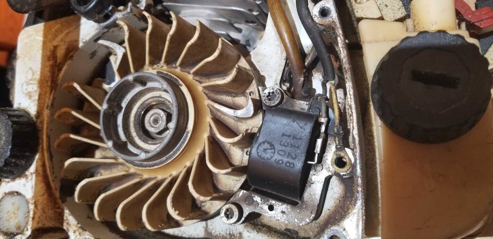

@ Flywheel bits found!
After the jug was removed, a small bump was found inside the intake.
From the outside, JB weld was applied to keep the air leaks in check.
Jug was found to be ported right through the intake side.
It was good enough for who it's for.
*Waiting for the new rubber bits, but Permatex is on hand!
Hogged they say it was! Go big and fill with JB.
