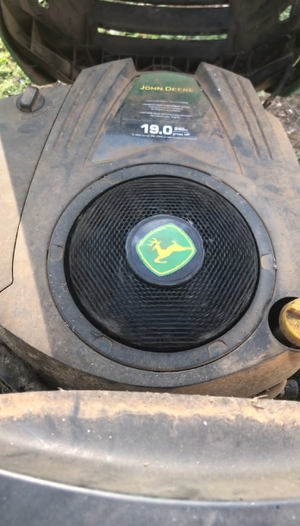

D110 Not starting
Redicliff
Active OPE Member
1:19 AM
32989
May 17, 2025
7
9
Lake County CA
The battery tests 12+
Key start produces one partial crank.
Time line:
First symptom occurred after running.
Short rest.
Started.
Short run.
No start same symptom.
see D110 no crank
Comments, advise and shared experience appreciated

What engine? Sorry I didn’t watch the video.
If it is the single cylinder Briggs engine, most likely the ACR on the camshaft failed. It is a small spring loaded weight that reduces the engine compression during cranking. These are a very common failure item, and they can fail at any time, especially if the engine has kicked back during startup. Pulll the OHV cover and make sure the lower valve (intake) is bumping open when the piston is reaching TDC on the compression stroke. If it isn’t, then the ACR has failed.

I would also say cam decomp.
If it stops winding at TDC turn flywheel by hand just past TDC and try again.
Post up results.

Here's report so far:
1. Found out how to kick start (
to get mower out of the walnut grove
2. Tried the magnet on a wire probe to try and locate ACR pieces in pan = no conclusive result
3. Adjusted valves: No joy.
So, despite #2 failure, I'm figuring it must be the ACR failure.
4. Ordered new OEM Crankshaft with ACR from PartsTree = $135 delivered
Not easy to locate a small engiine repair shop in our area and everyone is pricey these days.
[the John Deere Dealer in adjacent county has shop rate = $210/hr and quotes job as 5 hrs]
[ local guy is $85/hr and estimates 4-5 hours with initial diagnostics @ $75]
In any case, not easy to transport the D110.
Maybe I'll have to tackle it myself. We'll see.
