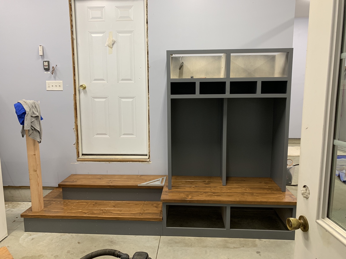

Finally kicked the temporary stairs out and started building this new entry from the garage to the house. Got to attach the top and build 2 doors on top and drawers for the bottom. The kids shoes and stuff is out of control. I’m not much better

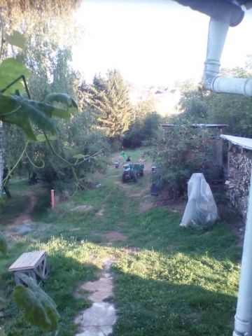

Installing a geothermal heatpump in a 100m dig.

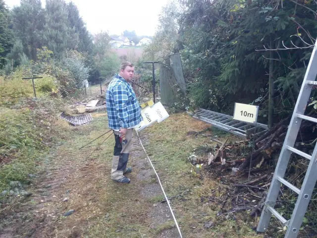

The beginning - measuring

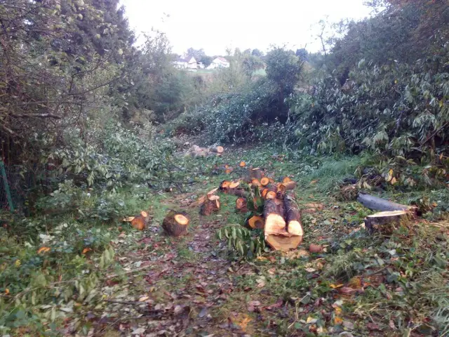

cut some trees at the old, 15years untouched garden area

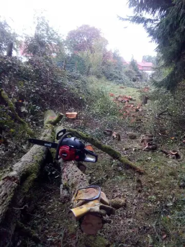

the beginning of my personal chainsaw virus: a MTD GCS 4600/45 with 45cc, 2,1hp and a lousy 1,3mm low profile / hobby semi chisel

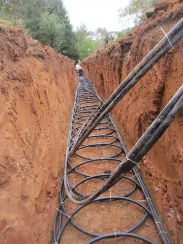

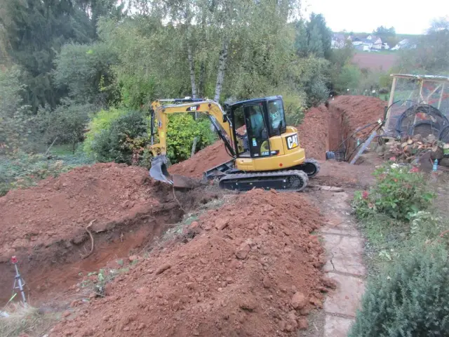

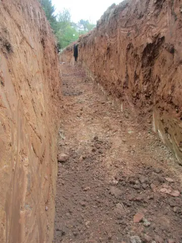

the dig will be 100m long / 2m depth / 1,5m width

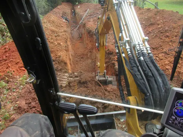

very funny to drive the excavator

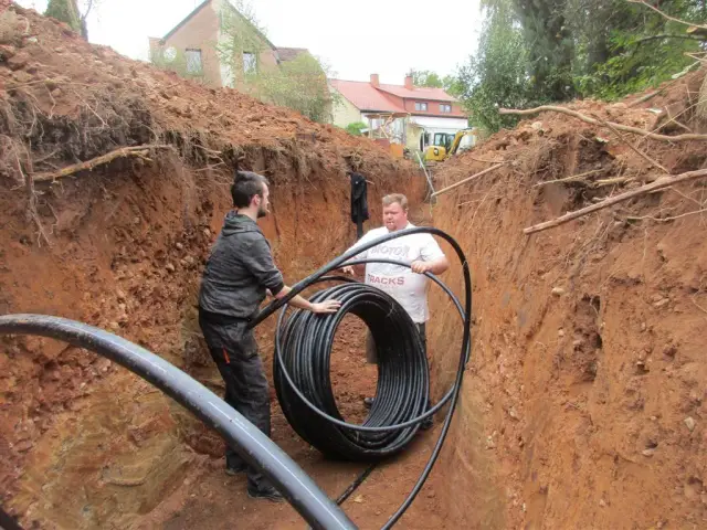

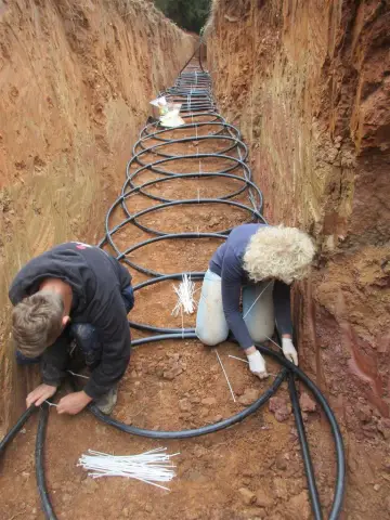

the heatpipe goes in slinkys
1.200 meters at all

You say you're 2 meters deep? That's a little further in the ground than I would prefer to be, with no shoring on the trench walls.
