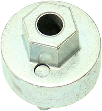

In the past I have been using the NWP 31112 which I believe is a copy of the Husqvarna 530031112 Pin wrench.
Today I ran into a clutch on a Craftsman [358.350180] where the pin are too close together to remove the clutch.
My question is: Would the 530031116 pin wrench have the slightly larger pin distance?

Curious aren't you? :)
According to images yes they are slightly further apart but I will need to wait on one as my distributor don't stock it. I was still able to get the clutch off as the drum stop it coming apart but the tool would have been easier to torque it back to specs.
530031112
530031116
Notice the pin location in reference to the 3/4" hex.
I will know for sure once the tool comes in.
