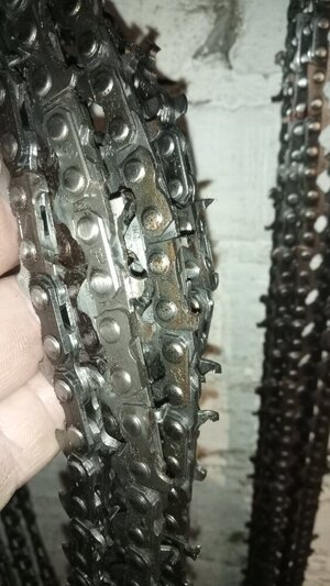

The loops seen to the right in the first picture are also stump removal chains, but 24"/84DL.
I may just scrap them, cutting a stump out of the ground demands control and a 24" bar does not excell in that department.
