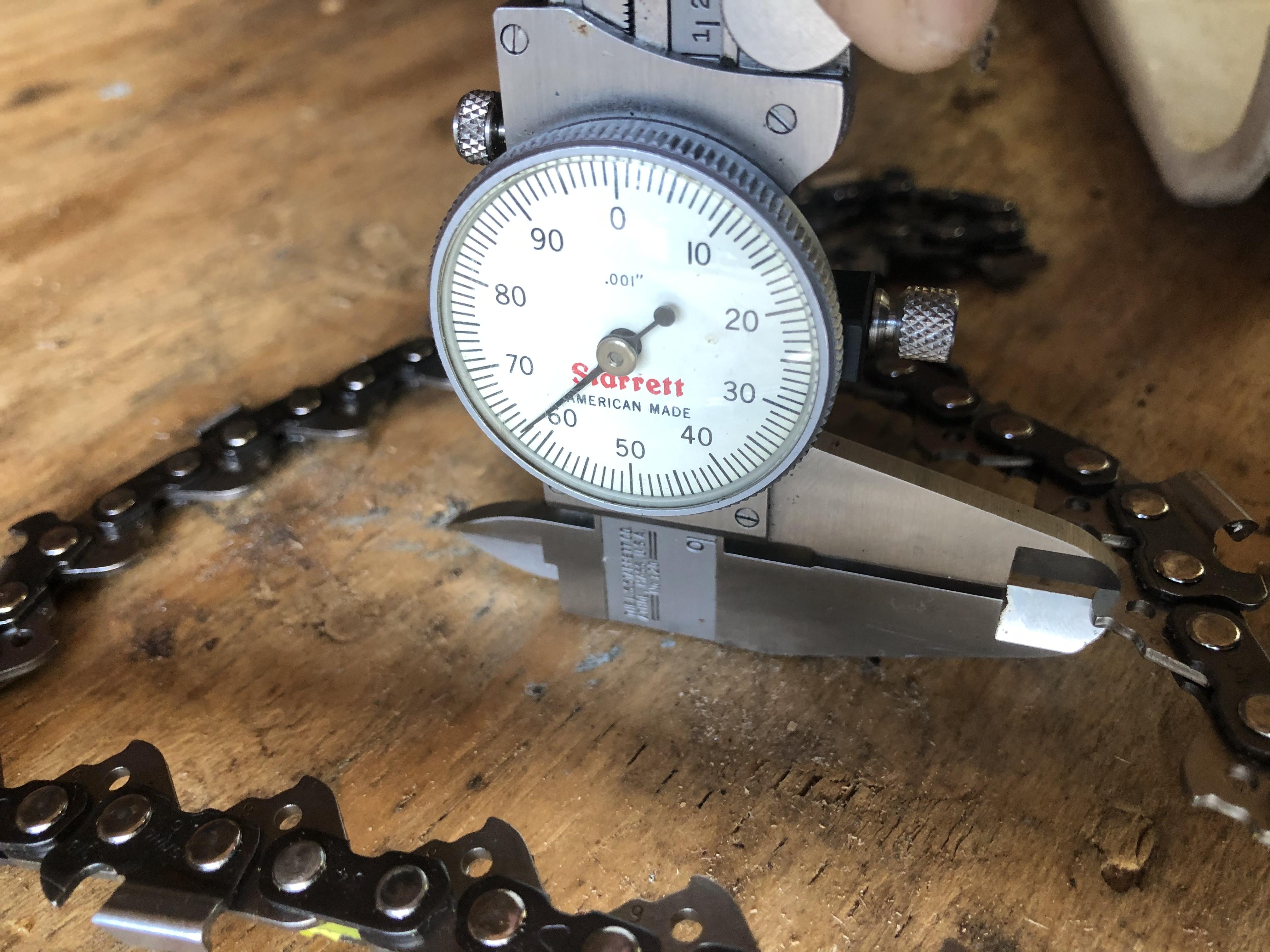

Stihl has a number system for the drivers. The little six on the drive link means .063. I believe 3 is .050 and 5 is for .058. Not sure what a 4 is for. I’ve never seen it.

84 links and this is a 63 gauge. Thanks man
Nice looking caliper you have there.

This is definitely Stihl RM in .063. I'm pretty sure that's what you have. You will like it, it's not crazy fast but holds an edge very good in dirty wood. It's pretty conservative on raker height out of the box, but gets grabby if you knock to much off.
