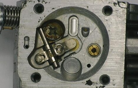

This is an example of the screw I am talking about:

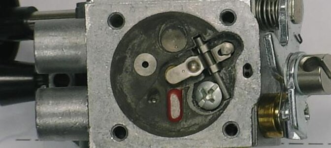

Notice the dull gray color of the aluminum where fuel has contacted it:
As I said, I have never been able to save a carb with contamination, so open yours up and see what it looks like, post a pic and I will look at it for you.
