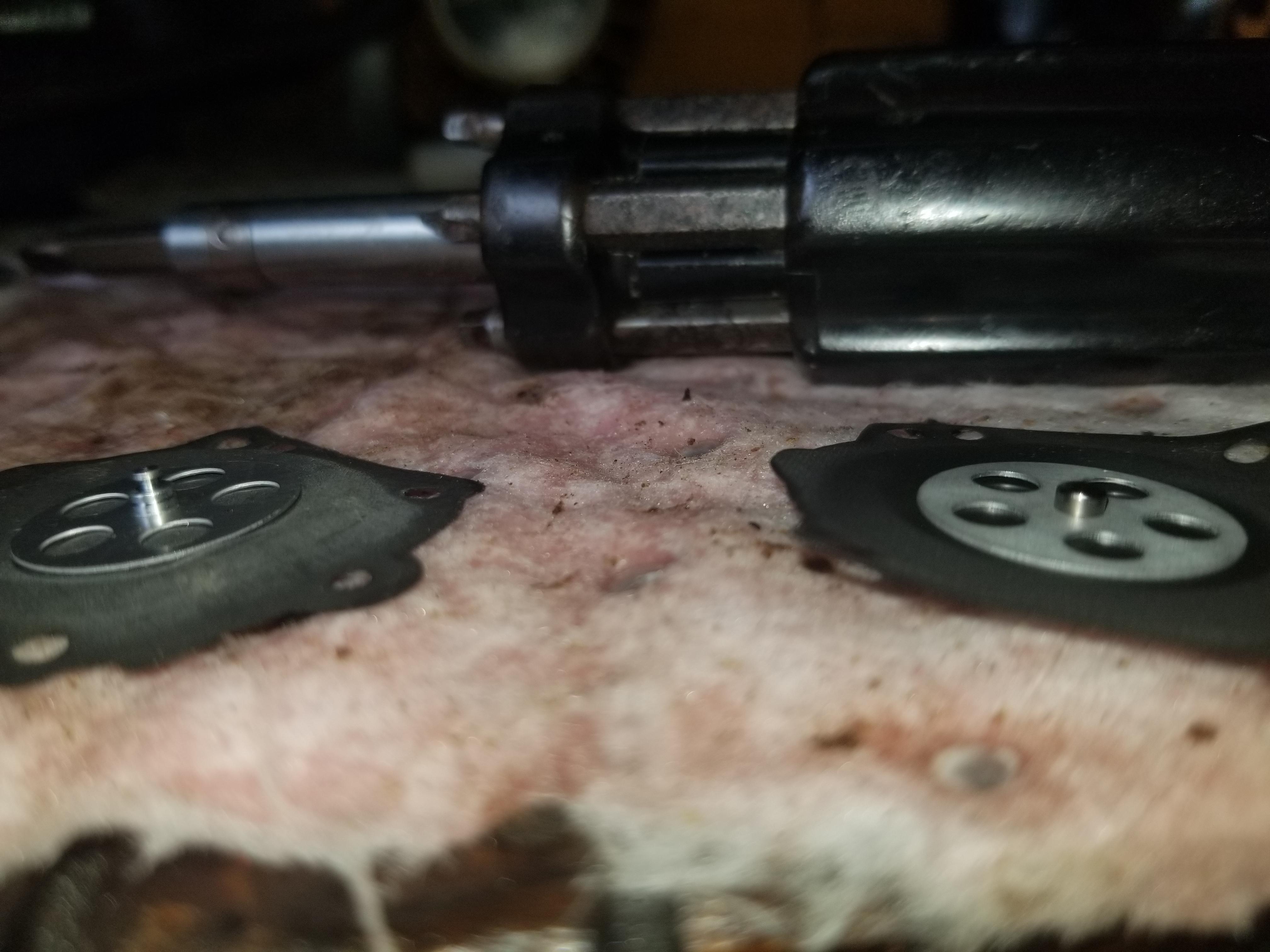

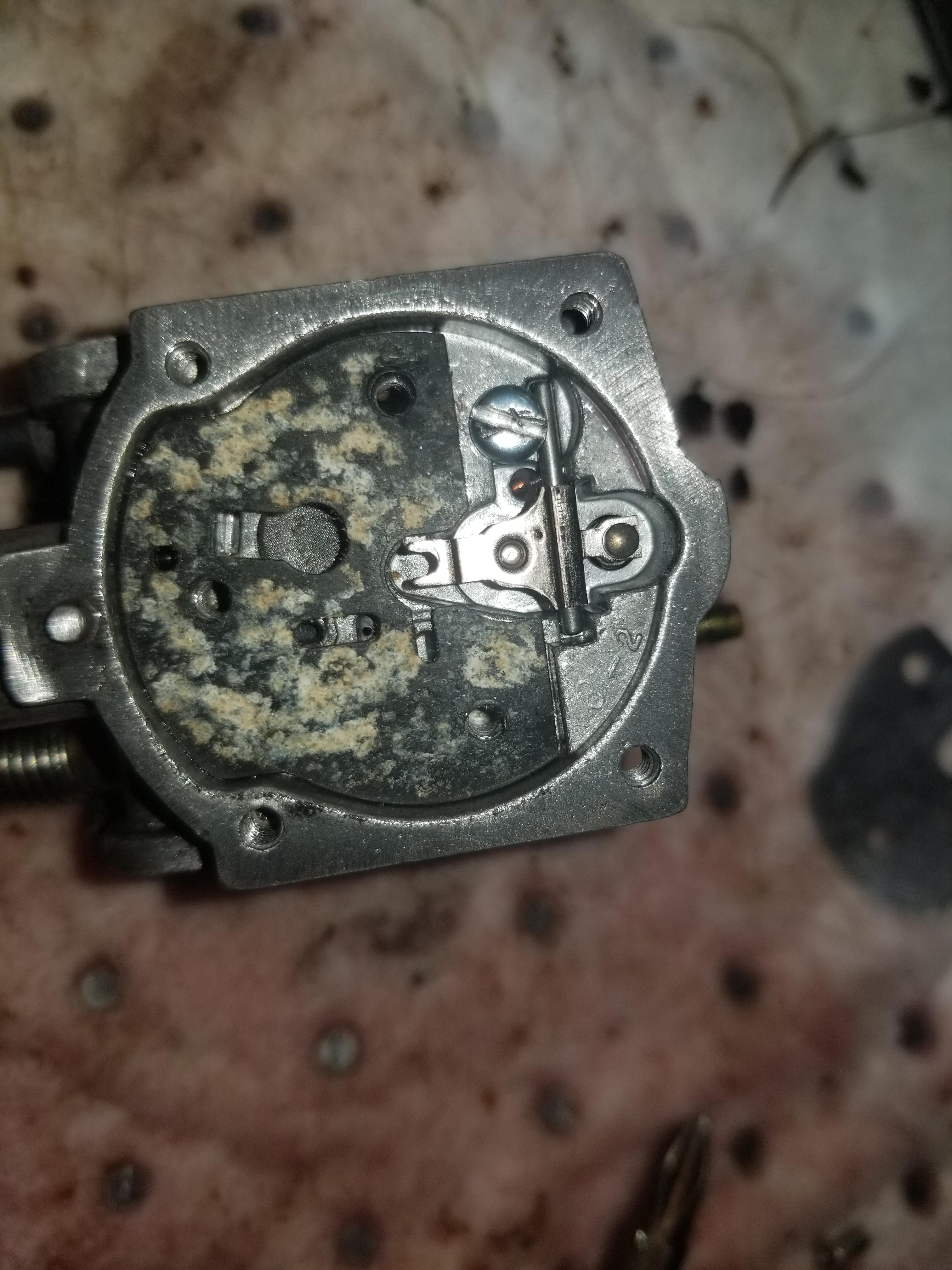

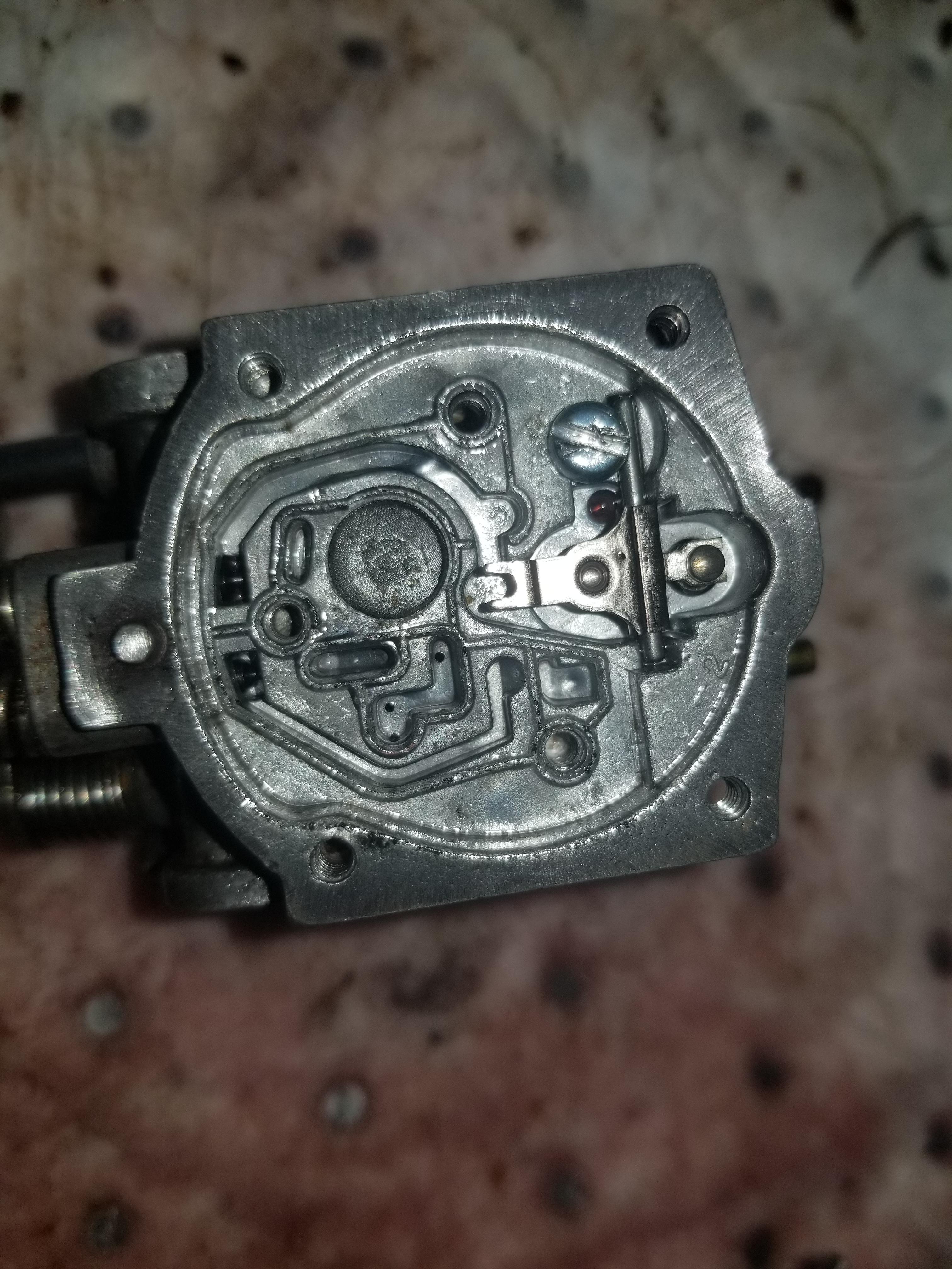

Working on a saw that would run ok then just randomly flood like crazy. Pulled carb to put new kit in and i think they had the wrong gasket in. Someone was in befor me. Gasket they had in has a slot. I think I need gasket without slot as that area has the raised ridge on carb body.
I have the gasket like what was in ther in the package too.
I put carb togeather with gasket i thought should be ther in it wont run off choke.
Only other differance is the diaphram. Old one has thingy for the forks on the meter lever and other dont. I dont think that matters?

Old gasket would let fuel flow to the meter lever area

Well studying this carb i do notice with the old gasket that opens up the idle jet port.

No problem, thank you for the information. The K10-WS repair kit is the one for this. The gasket in this kit is the one on the bottom of your first picture.

So with bottom gasket it wont run off choke. I put new gasket in like the top one and it seems to run pretty good. I made a bumch of cookies with it and nonproblems yet.
