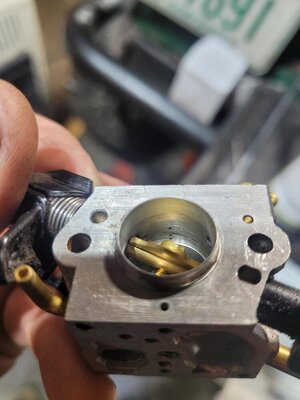

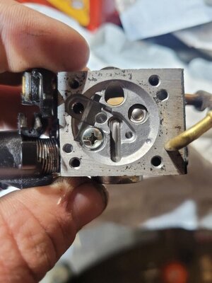

Anyone have a picture of what it looks like under the Welch plugs? I think the center jet is plugged but can't tell and don't want to pull the Welch plug unless I have too
