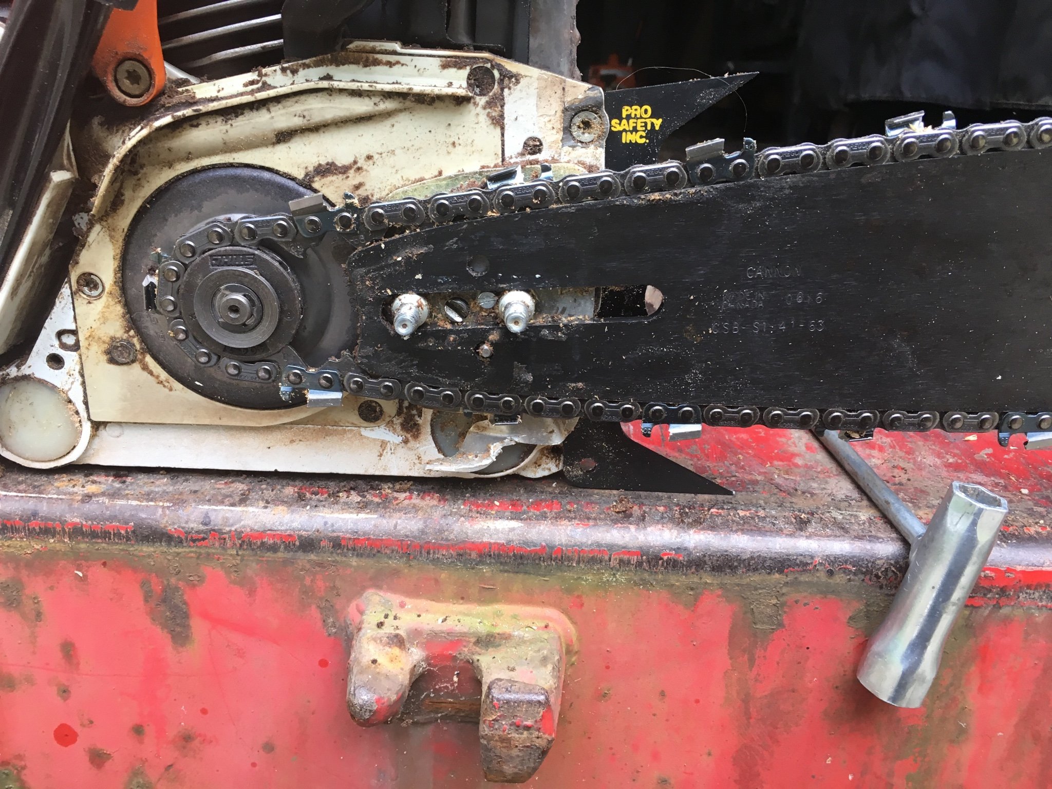

Yes it will fit after a little grinding making the bar alot longer.
So the Stihl mount has a longer tail, I’d need to take the slot back father? Or is it to match oiler or adjuster?

Lengthening the slot is to allow for adjuster travel with the use of an adaptor. The oiler holes generally line up pretty well.
11:26 PM
I would be curious to know if lengthening the stud slot is necessary on a Cannon bar? I'm going to check my D009 Cannon against my Sugi when I get home.
Not at all....I was whining this set up on my 395XP.
I just drilled a hole where I wanted it to end then cut off wheel to clean it up.
Pics? I've never held a cannon bar.

I believe the slot is longer on a Cannon, like on a Sugi Hara.
Pics to follow.
Pics to follow.
I’m going to call that 93mm.
Looks like 73mm.

The sugihara 42” stihl Mount I got here has a 110mm slot
The white bar in the above pics is a Stihl ES Light in 32”.
I just measured a Stihl ES 36”, & it’s the same length.
I want to say .750”/ 19mm is the amount needed to be removed from a standard 3003 mount Bar.
