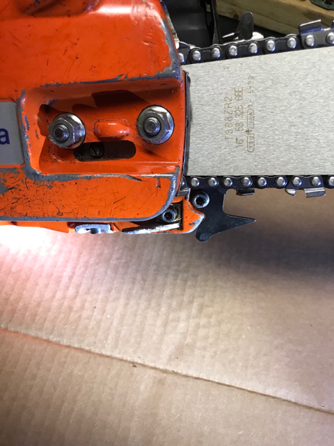

Built an OEM kick stand for a 346xp

Water jet reproduction???
Do the 357 dogs fit w some mild drilling??
I'm try to remember what model they came from but I did an easy swap w another bucking spike and it works well
I sold the saw so I can't check it

Yep 357/9 dogs fit. IIRC have to elongate one hole or trim a little off the back (it's been a while). 357/359 inner dog will also fit 257,261,262. Big dog kit will fit but the outer dog doesn't line up w/inner dog (about a 3/16"- 1/4" long). Just for info the 357/9 full wrap carry handle will fit 346. Just have to drill one mounting screw hole on the bottom.
455 dog fits, it’s not as nice as the OP’s solution but it’s functional. Think I had to grind just a little off the back side but the holes line up.
