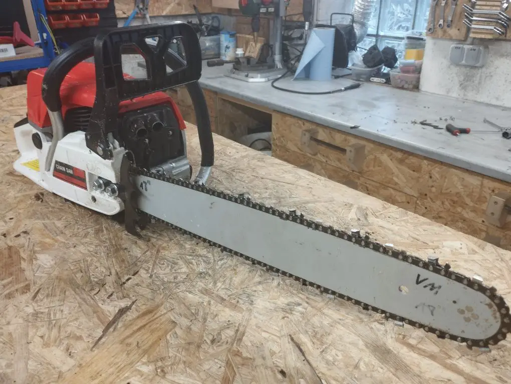

meanwhile I did some modifications on a cheap chinese 52cc saw I bought on eBay before christmas

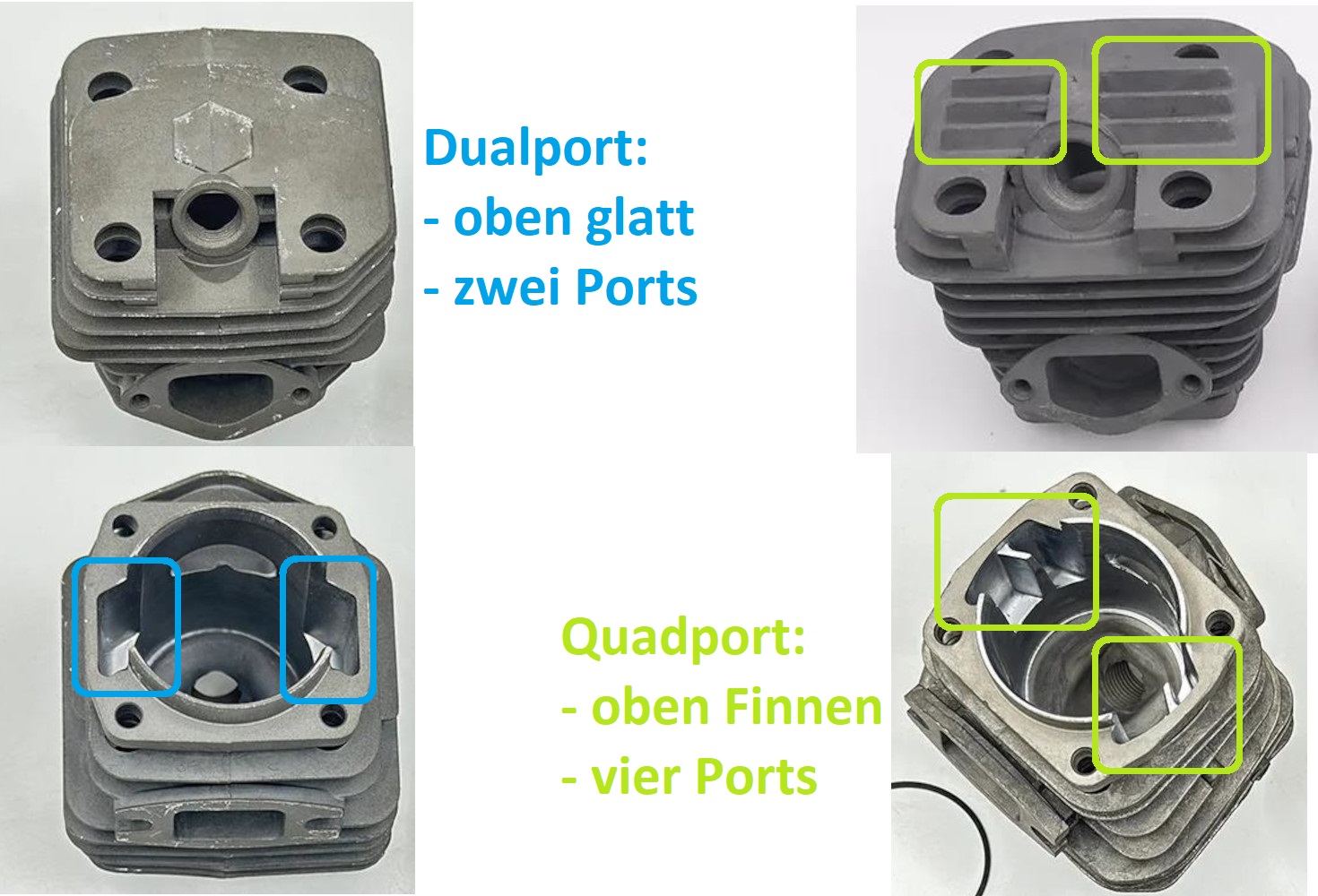

1. changed the orig. dual port cylinder to the better quad port version (higher agility, higher rpm at stock possible, higher torque)

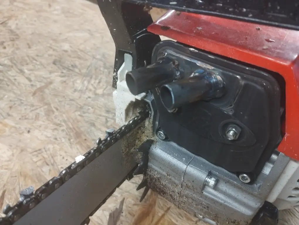

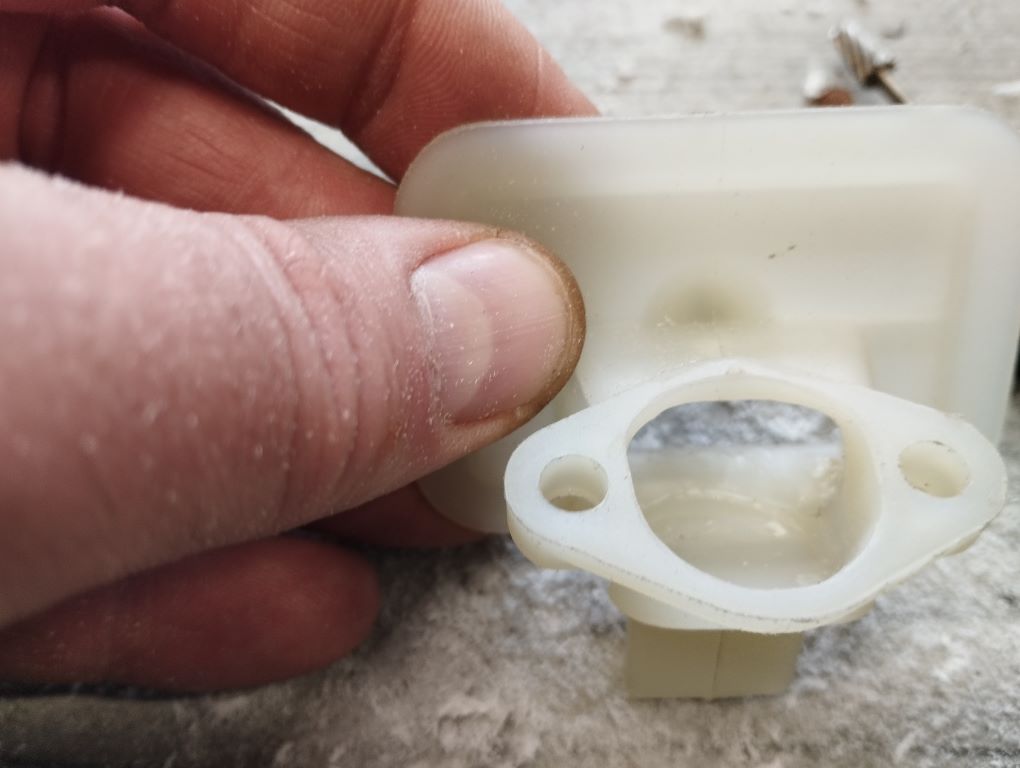

5. bigger carburator from an 372XP (with 3d-printed manifold to fit it)
left the dualport version, right the quad port

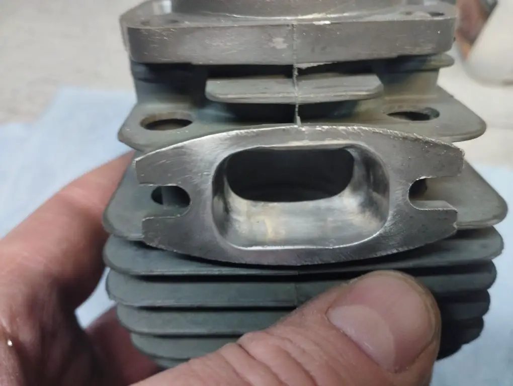

muffler mod, here without the paint

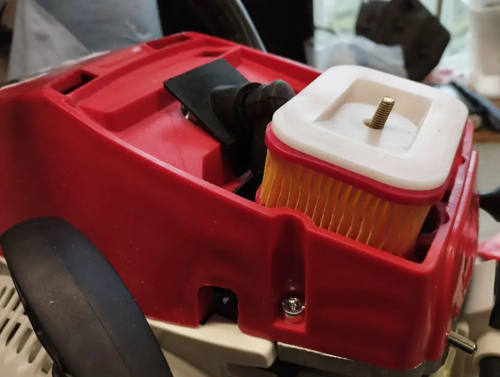

widened air filter intake
Tuning_52cc_Kettensaege_China_Weiss_Rot_Chainsaw_5200_noname_Papier_Luftfilter_02.jpg
Tuning_52cc_Kettensaege_China_Weiss_Rot_Chainsaw_5200_noname_Papier_Luftfilter_06.jpg

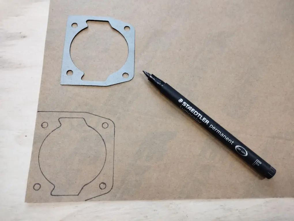

I made the base gasket out of 0,15mm gasket paper
Tuning_52cc_Kettensaege_China_Weiss_Rot_Chainsaw_5200_noname_Zylinderfussdichtung_base_gasket_04.jpg
modified 372xp carb. It's a little hard to tune at the chinese chainsaw, I have to raise the idle screw at maximum so the engine will not die when letting the throttle go after full speed

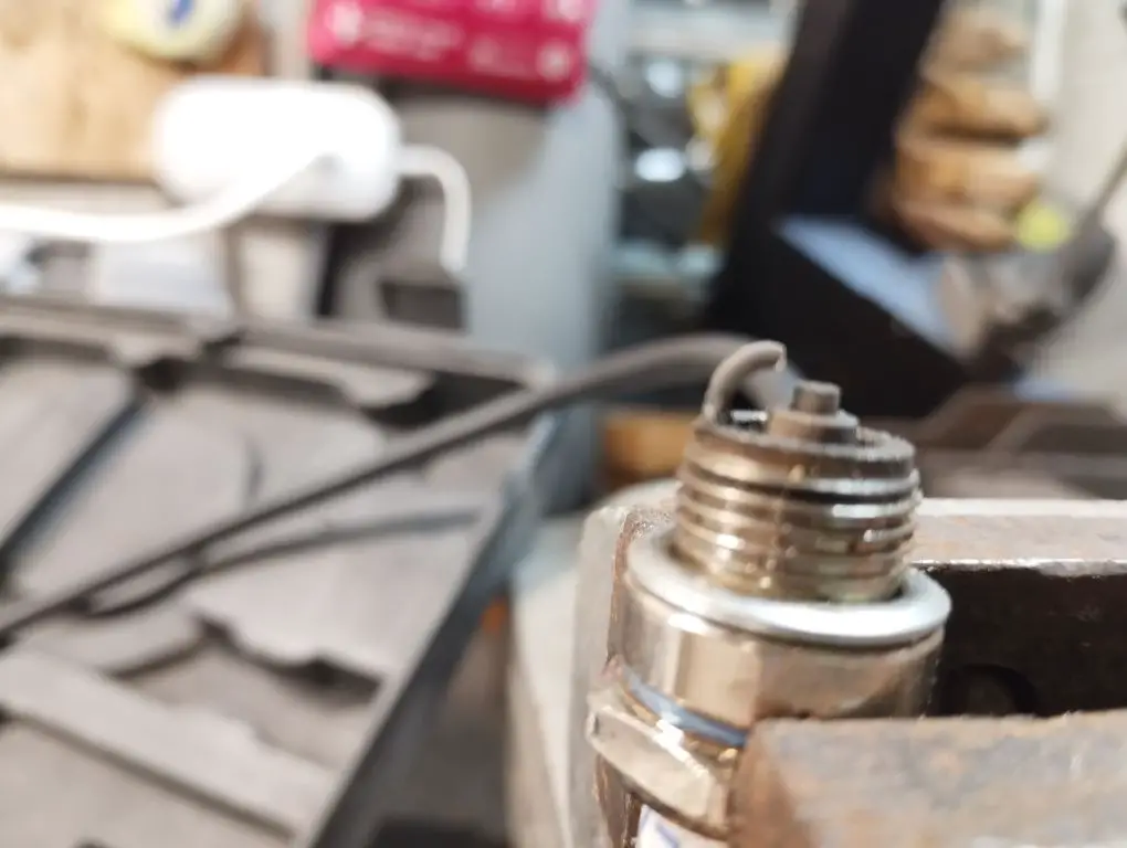

side-gapped spark plug
Tuning_52cc_Kettensaege_China_Weiss_Rot_Chainsaw_5200_noname_Zuendkerze_side_gapping_02.jpg

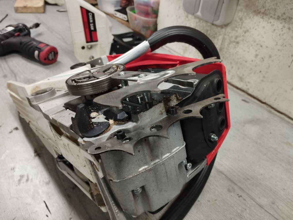

just for fun: adapting some 372XP felling hounds to the chinese saw
Tuning_52cc_Kettensaege_China_Weiss_Rot_Chainsaw_5200_noname_Baumkrallen_felling_hounds_16.jpg

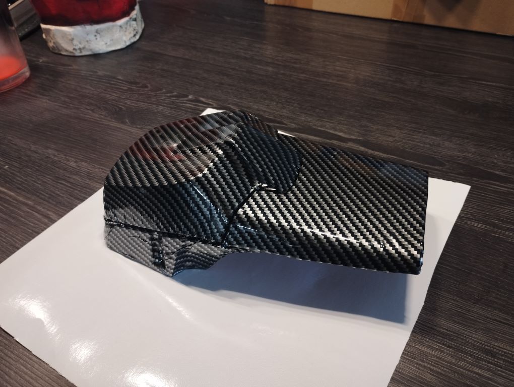

and I will try to have the look of the Holzfforma Pro for my cheap chinese saw by foiling some parts with carbon look foil
but honestly I am not happy with this work and maybe I will try to do this again with hydro dipping but this is new for me too.

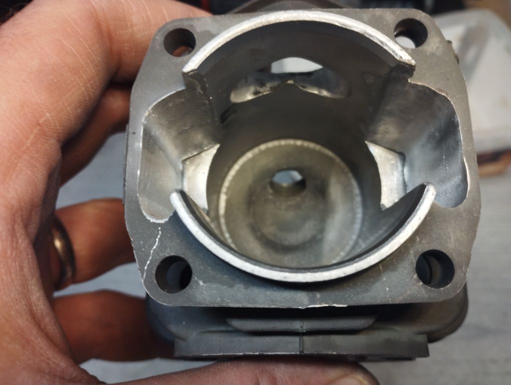

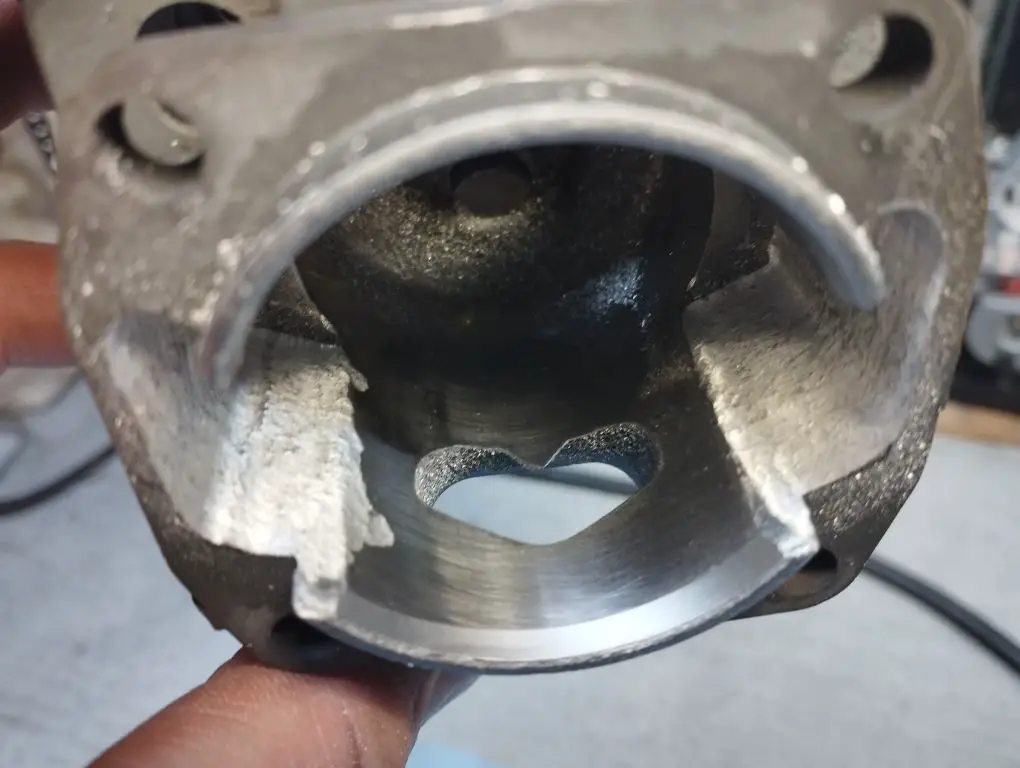

actually I am working on porting the cylinder.
Because this is my very first try I used the "old" dual port cylinder, What I've done:
-widened the intake (just left and right, no timing changes in high / depth)
- widened the exhaust outlet (just left and right, no timing changes in high / depth)
- widened the transfers
- polishing the exhaust outlet
yesterday I tried the cylinder in the wood but the cutting times are getting worse (38sec instead of 35sec before).
I guess it's because I did some mistakes while porting by slipping away with the dremel and hitting the cylinder coating.
Or because I was not able to do a better carb tuning. The cutting felt like the saw wanted more fuel and I tried to adjust the carb more rich but then the engine will die after full power.
What do you think?
Next try will be to port the good quadport cylinder and be more careful with the dremel in particular when working with the rotating direction,
but I would also like to figure out what's the problem with my first porting job at the dual port cylinder

I could never get the dual port jugs to perform as well as the quad port one do stock. It’s pretty crazy how what stone pellet think would be too big of a carb for this saw makes a way bigger difference than anything else.

There is a guy on Youtube at UK which is porting these chinese saws very high and he swears on the dual ports but I am not sure he ever tested out the quad ports. But I think what he saying is right: the transfers of the quad are significant smaller then the dualport because of the devidier. Thats the reasson why I tried very hard to widen the transfers at the quadport top end.

Actually I do a little work on a 62cc model with 372XP carb I can't get to run propperly. The carb is not adjustable well, at this point I haven't figuered out the problem. Maybe an air leak somewhere, maybe at the 3d printed manifold, I have to do a closer look

I see youre from Germany too. You can buy the parts for using an 372XP carb on the chinese G5000 chainsaw here on eBay
